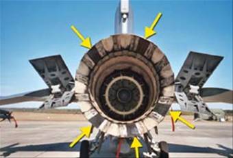

From Livefist blog,
Somehow this pic tells me, we already started adopting Snecma technology or getting guidance from Snecma in designing & maturing our Kaveri engine.

Kanson wrote: Somehow this pic tells me, we already started adopting Snecma technology or getting guidance from Snecma in designing & maturing our Kaveri engine.
Just curious to know. How?!
Posts: 60372
Re: Kaveri & aero-engine discussion
Exhaust temp?
Kanson
Posts: 3065
Joined: 20 Oct 2006 21:00
Post by Kanson »
Use of CMC for exhaust nozzle(Check the pic from my previous post). Snecma is the pioneer in using CMC for exhaust nozzle. GE and other majors are learning the ropes only recently.
GE plans to introduce CMC for LPT section in the core but from the slides exhibited in Livefist blog, we are working with MMC (Titanium Alluminide - SiC) even for compressor section and one may recall DRML pics of casted Alumina Ceramic BLISK that came in 90s. However, we are not still forthcoming on developments and achievements on Single Crystal and materials design for the hot section. In my assessment, we are working on cutting edge technologies and trying to close the gap in all areas and i believe we judiciously chosen Snecma as the partner for leapfrogging us to future engine material technologies.
Snecma CMC nozzle flaps for PW F100 engine.
http://www.wpafb.af.mil/news/story.asp?id=123116097
9/19/2008 - WRIGHT-PATTERSON AIR FORCE BASE, Ohio -- AFRL engineers are working with industry partners to test the use of ceramic matrix composite (CMC) materials as divergent seals in F100-PW-229 gas turbine engine exhaust nozzles. Geared towards increasing part life, improving reliability, and reducing operating and maintenance costs, the research is focusing on SEPCARBINOX® A500, an advanced self-sealing CMC manufactured by French company Snecma Propulsion Solide (SPS). Thus far, the seals have performed extremely well, and a life-cycle cost analysis is under way to determine whether they should be introduced into the fleet as preferred spares.
CMCs are excellent candidates for replacing the nickel-based superalloys currently used in exhaust nozzle parts, primarily due to their capacity to withstand the high temperatures and severe operational environment for much longer periods of time with minimal changes in structural behavior.
In examining the feasibility of using the A500 seals on the divergent section of the exhaust nozzles, AFRL researchers are addressing a number of key Air Force issues--one of which involves the performance comparison of CMC parts in flight and during engine ground testing. SPS has developed a novel CMC that uses carbon fibers in a sequentially layered carbide matrix produced via chemical vapor infiltration. Because this resultant matrix is self-sealing, it helps protect the carbon fibers from oxidation. The fibers are woven in a multidimensional, ply-to-ply angle interlock pattern to reduce the chance of delamination.
