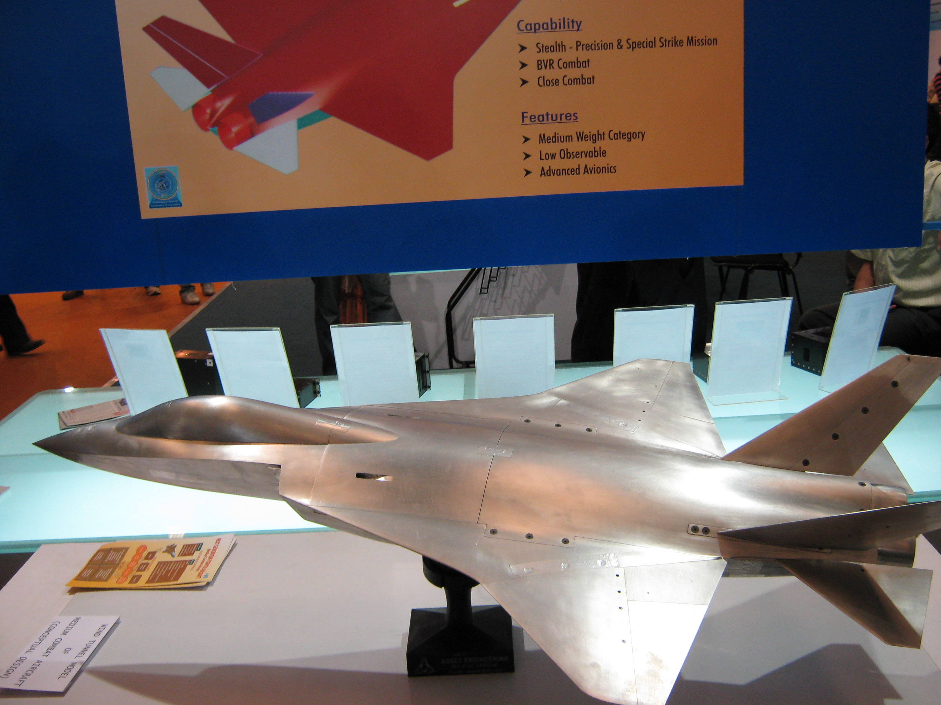

:D
Eureka - I found it!
Our controversial friend Prof Prodyut Das has a great article in Vayu, but more to the point here is his comment on the AMCA model at Aero India :rotfl:
http://idrw.org/?p=18444
For the AMCA display model to have been built it must have gone up several layers of “top” management. The pity is that no one bothered to see and check the glaring errors in the configuration. The fin shape – particularly the leading edge sweep is all wrong – perhaps not fit for a propellor driven trainer let alone a stealth aircraft.
And what are those deep boundary layer diverters doing on a apparently fifth generation combat aircraft? Even the “Wang Lu laundry and Chop suey” aircraft companies – very respected incidentally for their track record -are using diverterless intakes. The Western Aviation companies must be laughing up their sleeves because if this is the best ADA can do then AMCA like Dilli is “dur ast”. A unsuitable configuration -if translated into a prototype can be the devil to develop- witness the LCA.
What ADA needs is more seriousness at the Project engineering level. Unfortunately in India “Good manager ” has always outweighed “Good Engineer” in the promotion sweepstakes and when the troops come up with a model that is suitable for Bankipore Fair there is no one there to make the simple corrections!
In fact I did think the AMCA fin looked stupid, but I could not say what was wrong. Click on image to enlarge.
India has virtually no scale model industry and we make among the worst models I have seen. Last week at a party in Sanjay Simha's house I saw a model of Mahindra's NM 5 made by HAL or someone. That is the ugliest model I have seen in my life - besides it would not stand on its three wheels and toppled tail down.

shiv wrote:In fact I did think the AMCA fin looked stupid, but I could not say what was wrong. Click on image to enlarge.
If you look at previous scale model, the fin looked more like F-18. And here it is kind of 'different' if i can say that.
Check this, http://images4.wikia.nocookie.net/__cb2 ... craft1.jpg
