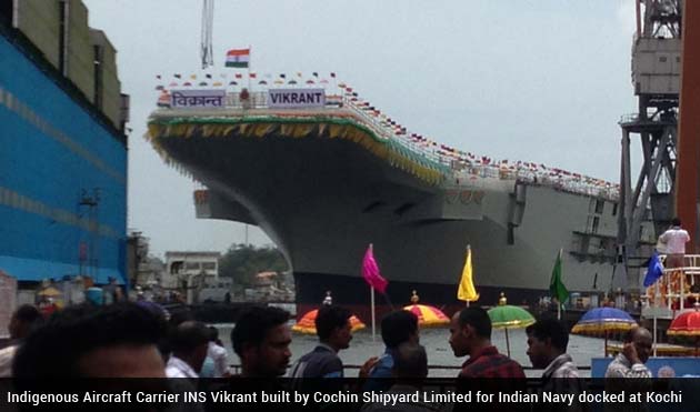

Another image that I haven't seen posted here yet:
Both the section that mounts the island + twin elevators (slots visible) on the visible side, and the angled deck on the other side, remain to be attached.
Elsewhere, I've seen pictures of the bridge section lying on the ground at CSL, so it looks like the fabrication of these two sections is at least partially done too.
I can't speak for why they didn't install those before the launch. Perhaps design choices warranted launch readiness now, or GoI leaned on them to launch in time for I-day, since there'll probably be elections before the next one.
The build quality does look quite good, as Katare said.

What are the sponsons at either side front for? Ak-630?
http://4.bp.blogspot.com/-2l9cyl8vH_c/U ... 779942.jpg
The launch "t402" looks like navy/sagar prahari ball ... any idea of the model?

Post by Eric Leiderman »
Suraj there are at least a couple of reasons that the island and other appendeges have not been welded on before she is floated out of the graving dock
1) you will see spoonsoons attached to the hull, that means that there is a restriction on the vessels draft which the sponsoon s counteract with their extra buoyancy, so less the superstructure less the requirement for buoyancy.
2) from a shipeyard real estate point of view , it is much more costly to keep a vessel in a dry dock than alongside a quay.
vessel's hull is now water tight and the remaining work can be done with her afloat at a cheaper berth.

ABP news link posted above gives a good idea of the size as it pans the IAC's entire length.
One of the Navy personnel was quoted as saying it is like 4 acres on deck, and there are 10 stories in total.
