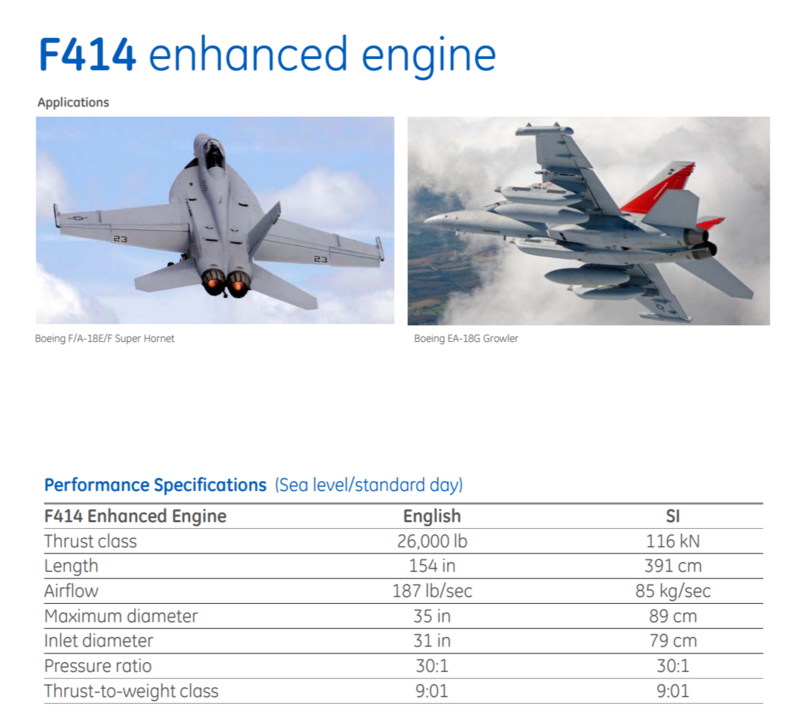

F414-EPE
"Enhanced Performance Engine" or "EPE", includes a new core and a redesigned fan and compressor. Offers up to a 20 percent thrust boost, increasing it to 26,400 pounds (120 kN), giving an almost 11:1 thrust/weight ratio.[16]
^^ the tech for the above is on the shelf with GE but USN did not fund production.
we can fund it to completion and also sign a deal to make most of the parts here barring any critical IP guarded by laws.
they dont have much to lose because F135 and new AETP are already their future engine and F414 is one behind.
we need to ask to use that design as the base for our 110lb future engine.

https://www.geaviation.com/sites/defaul ... hanced.pdf

I think the US DOD, the US Navy and GE can be convinced to go ahead and fund or co-fund the 116 kN variant of the GE F-414 if there is enough on the table for the contractor and the US Navy to pursue it. Let's say 100 fighters - that's a 200 engine order. Perhaps 50 or so for retrofitting on MWF and before you know it that's probably the largest export engine order any western OEM can realistically hope to secure for a non native (to the engine OEM) platform. But to do something like that requires a fairly substantial CAPEX and getting ahead of the demand and putting an offer out there. As far as I can tell, even the MK2 99 F-414 order has yet to be signed so in a way HAL is still catching up to demand which was established nearly a decade ago (99 F414 order for MK2) so there is quite a bit of work to make the ends meet. It may just end up being the case that USN's need to fund the enhancements comes to fruition before any movement is made to seek something that is more powerful than the baseline F-414.
Re: Advanced Medium Combat Aircraft: News & Discussion - 30 August 2019
I am pretty sure, India, SK & Turkey will go for F414 EPE version. Even at 100 jets each, that is 600 engines. And i know it will be more than 100 jets each.
All the 3 programs have similar timelines. So they would require the engines at the same time.

fanne wrote:For a AMCA to super cruise it needs 120 kn engine, not the f414. No one is making one yet, and we have to we one very lucky in orders of magnitude over our new clear and space capability to pull this off. AMCA as planned now is DOA. Perhaps the establishment (including the iaf one) will wait for the current chief to retire.
120 KN? Where are we getting these requirements from? Has IAF/designers stated this?
Posts: 9207
Cybaru wrote: 120 KN? Where are we getting these requirements from? Has IAF/designers stated this?
Not to my knowledge. But BRF designers, with their vast and unmatched experience in designing fighter jets in their own minds have decreed it.

@brar_w, is there an estimate from GE on how much it will cost to productionalize the EPE engine? Honestly, I don't see any other options, Indo-French engine is just a pipedream, EPE is the easiest way to get there. We can come to an agreement with GE (maybe spread the cost across USN, SoKo etc) in exchange for deep screwdriver-giri. Keep in mind we a paying the French over a billion euros for "customizations" - surely we can spend some for 200+ Mk2 plus whatever number of AMCAs.
There is no publicly available costing data though once you factor in the engineering changes, the test and validation effort you are looking at mid to high hundreds of millions at least. More if some of the improvements that have happened at GE since they defined the EPE years ago are to be incorporated.
Yeah the 120 KN is not coming from anywhere official. The link that started the current series of posts and discussions itself speaks of 110 kN only with no reference to 120 Kn at all.

The article says DRDO/ADA is angling for 110 KN engine (my bad, I do not know from where 119 came about, perhaps I was suggesting to go for an available engine that has a required thrust, rather than 110 KN engine, there exist none, apologies) -
"Consequently, the decision has now been taken to go in for two squadrons of AMCA Mark-I with the “available” General Electric-414 afterburning turbofan engine in the 98 Kilonewton thrust class.
“The next five to six squadrons of AMCA Mark-II will have a more powerful 110 Kilonewton engine, which will be developed indigenously with foreign collaboration parallelly. The super cruise of Mark-I will be slightly limited due to the older engine but it will be upgraded in Mark-II,” said a source."

fanne wrote:https://timesofindia.indiatimes.com/ind ... 798166.cms
Got it.. your note was lost in there.. Highlighting it, to stop further discussion on mythical 120KN engines.
Posts: 4591
I think it was a typo from 110 to 119 (9 and 0 being side by side).
