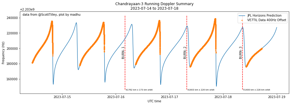

question for gurus,
https://twitter.com/coastal8049/status/ ... 93249?s=20
Scott Tilley has plotted the residuals for the Doppler data and the JPL Horizons data. the error is consistently reducing for each burn. the question is the increase in perigee from 173 to 221 is to reduce this error? any information on this please.

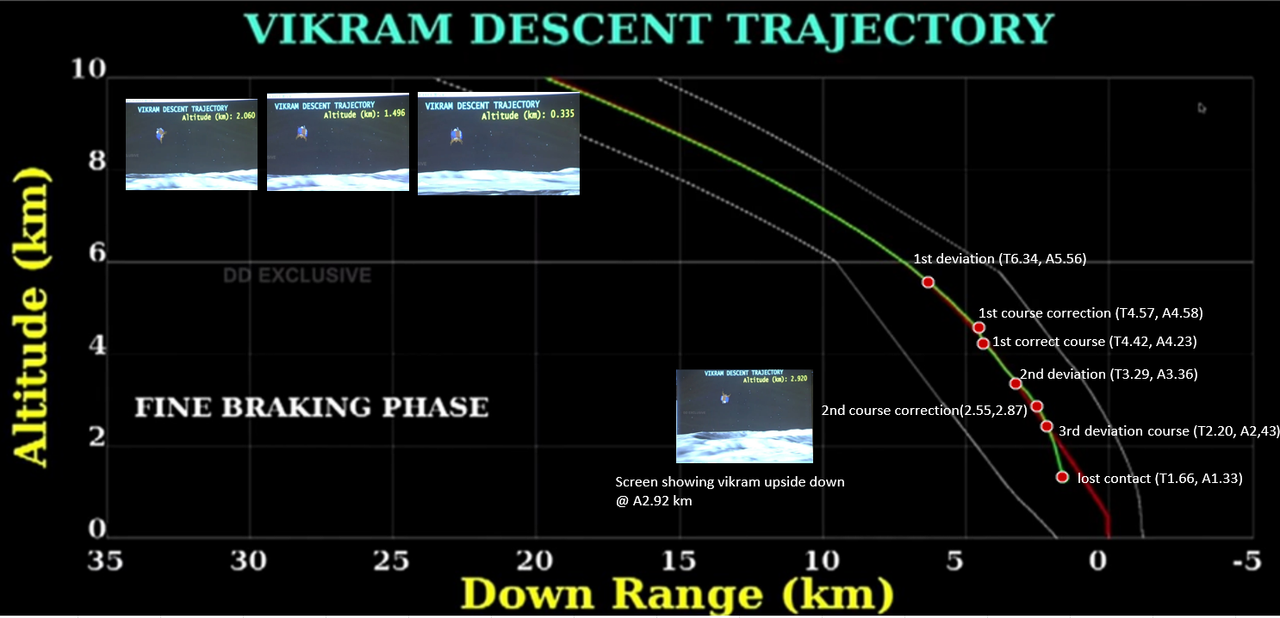

Here is the recap of the trajectory of vikram detailing all the deviations and to some extent orientation of vikram.
Re: Chandrayaan 3: Launch and Discussions
juvva wrote: 18 Jul 2023 05:21
SSSalvi wrote: 17 Jul 2023 21:05
If I remember correctly the problem explained that time was ( Trying to explain in my language ):
1. Large deviations were not expected
2. So after ( suppose it is a 16 bit processor ) FFFF Hex, the value (say ) was 10000 Hex.
3. Since the processor was not programmed to handle beyond FFFF ( because deviation beyond that was not expected ) the system interpreted it as 0000 ( ignored the carry 1. ) and thought that more power needs to be pumped, and fired the engines more while it was expected to reduce the power.
Logically seems to be correct analysis.
sounds like pslv-d1, all over again...
At first blush, sounds like PSLV-D1 but I do not think that is what SSSalvi'ji is saying in his inimitable style.
I think the issue is not buffer overflow of PSLV D1. It is definitely a software algorithm issue.
Here is what the C3 has over C2
1. Removal of the central thruster.
2. Addition of Laser doppler velocimeter
For the moment lets assume that In C2, the velocity must have been a derived value. Based on various calculations on the rocket burn time, the initial rate of approach etc. Keep this as derived_velocity attribute.
The lander was given a specific target, and as it approached the target, its parameters were to approach it at a specific velocity and angle. Keep this as intended_target attribute.
Now from here there are two paths that open up:
1. As the lander descends, it needs to know how much burn it has to do to reach the intended target.
2. And approach the intended target at the correct velocity
For item #1, it has to increase the burn and that will increase the velocity. However it has to reach that particular spot and the increased velocity is not desirable since
3. It will overshoot the intended_target AND
4. The derived_velocity of approach will be very high and over the margin.
That means that the braking rockets need to fire to bring the lander under the velocity limit. However doing the same will mean the thrusters have to fire more to approach the intended_target.
This back & forth firing increased the attitude deviations which led to a circular lock in to more thruster firing. Think of it as locked into a thrust/counterthrust "outward" loop. That is the errors now build up leading to more errors (attitude deviations) and this overwhelms the computing unit while the lander runs out of fuel. Thus a crash land.
The changes in C3 is now significant. First of all, the algorithm is "opened up". Instead of going to a particular target, it gets a set of targets and parameters, all achievable. This set of targets are identified by the excellent survey carried out by C2.
Second, with the laser doppler velocimeter, at any point the lander knows its true velocity. So now the algorithm, just has to calculate what targets are reachable given its current velocity and approach one of the priority and as it reaches it, fire the reverse thruster and hover over the target and land.
Also the central thruster which was added to clear the moon dust away is eliminated. And does not compete for its share of fuel.
In nutshell, the algorithm locked in and tried to manage its "approach" parameters instead of "given the approach parameters", which target can be achieved.

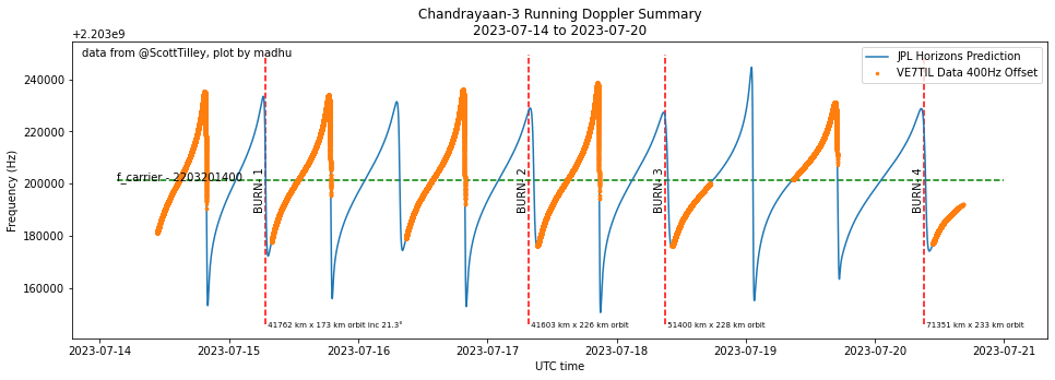

I am tiring to recreate the doppler summary from ScottTilley data. I see that Burn-2 and 3 matches exactly at the peak and the timing of them is more or less accurate from various sources. I do not have the exact time of Burn-1.
please correct me, my understanding is peaks in the plot corresponds to apogee and perigee right? and firing for orbit-raising maneuver should match the peaks?
any one know exact firing time?
madhu wrote: 19 Jul 2023 17:05
As I understand, orbit raising burns are always performed at Perigee and Orbit inclination changes are optimal around apogee.
I think the chart is trying to say that the peak is post perigee burn OR the doppler peak corresponds to the perigee, as the craft approaches Earth, the doppler peak rises.

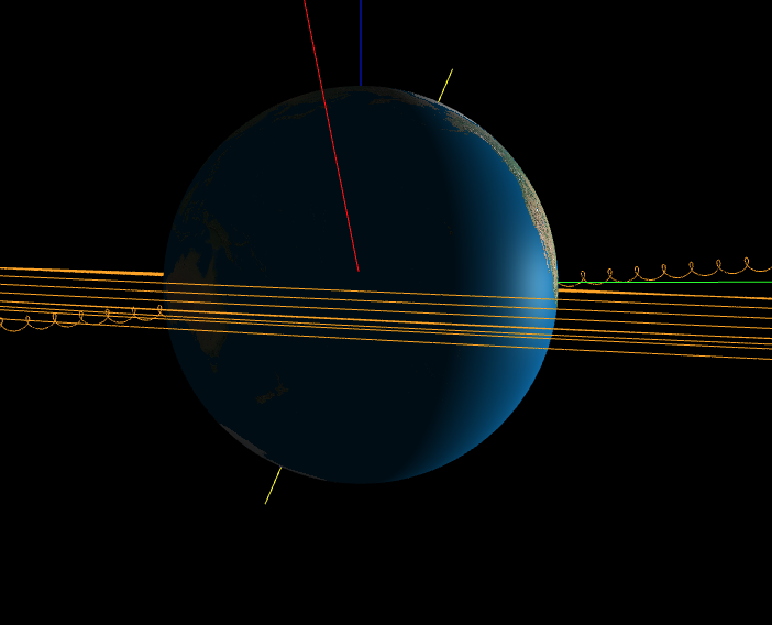

Just for fun!
1st Image : Part of Earth orbit ( Light Yellow ) and Moon ( Green ) during initial period of Ch3.
2nd Image : Orbit raising period track of CH3 ( Pink )
3rd Image Earth to moon transfer and subsequent movement of CH3 around Moon ( Yellow )
4th Image : Deatailed view of Moon snatching away CH3 from Earth orbit

thx S^3 ji, adding source will help in long run. i know you are taking it from ISRO tweet but a link will be handy so adding it for your help
Code: Select all
orbitRaisingManeuver =[
    '15-07-2023 12:17:00', # The first orbit-raising maneuver (Earthbound perigee firing-1)
                           # source:https://twitter.com/coastal8049/status/1680090422335655936?s=20 (2023-07-15T06:47 UTC)
    '17-07-2023 13:14:00', # The second orbit-raising maneuver (Earthbound apogee firing)
                           # source:https://twitter.com/isro/status/1680845817903722497?s=20 ( from time stamp)
    '18-07-2023 14:30:00' # The third orbit-raising maneuver (Earthbound perigee firing)
                          # source:https://twitter.com/amsatdl/status/1681234136814559232?s=20  (2023-07-18 08:22:00 ITC)
                          # but isro tells its at 14-15 hrs https://twitter.com/isro/status/1680845817903722497
    '20-07-2023 14:30:00' # The fourth orbit-raising maneuver (Earth-bound perigee firing)
                          # source:https://twitter.com/isro/status/1681960236347965440 (considered middle b/w 2 & 3)
                          #     https://twitter.com/isro/status/1682029955746770944?s=20 (71351 km x 233 km)
CY3Orbital = [
    ' 41762 km x 173 km orbit inc 21.3°', #orbit-raising maneuver - 1; spacecraft is now in 41762 km x 173 km xorbit
    ' 41603 km x 226 km orbit',           #orbit-raising maneuver - 2; spacecraft is now in 41603 km x 226 km orbit
    ' 51400 km x 228 km orbit',           #orbit-raising maneuver - 3; spacecraft is now in 51400 km x 228 km orbit
    ' 71351 km x 233 km orbit',           #orbit-raising maneuver - 4; spacecraft is now in 71351 km x 233 km orbit. ]

#Chandrayaan3 time-lapse at the end of today's observation @SternwarteBO. JPL/Horizons trajectory data was good enough for tracking! Thanks @isro for the update.
shows the jumping of frequency as soon as the spacecraft approaches the perigee. I was following it from 12.00pm today till CY3 set at observatory.

SSSalvi wrote: 20 Jul 2023 10:46 Just for fun!
Nice plots. Especially the 3rd and 4th plots show the track of CY3 being injected into a lunar equatorial orbit and immediately being steered/forced into a lunar polar orbit. That's quite the 90 degree turn; the thrust generated by its on-board engines. The lander and its electronics must be seeing tremendous stresses from the drastic change in trakectory.
SSSalvi
Posts: 787
Joined: 23 Jan 2007 19:35
Location: Hyderabad
Post by SSSalvi »
That '90 deg turn' is not by rocket motors.
Actually after the Lagrange1 distance ( it is the distance between Moon and Earth in this case ) which is an equi-potential type of situation where the gravitaional forces of Earth and Moon are equal and depending on whether thw satellite is in Moon Gravity or Earth gravity it will be pulled by it, and will either crash into the body or orbit it depending on the situation.
Here is an image from my old blog ( It shows Sun L1 point though )
1.At that time the CH# is near Earth Apogee so its speed is very low
2. It is beyond L1 distance
So. as Moon comes near by CH3 gets 'pulled' in its gravity rather than it being pushed into Moon orbit using force onboard. And Handover Takeover is very smooth because CH3 is almost no speed at apogee..
It is the matching of timing and distances that the ISRO magicians are playing and then watching the fun.
And, we enjoying the multi party tussle.

here is the updated trajectory monitoring plot. as per scott's tweet the spacecraft made a low pass just after the post burn-4. next challange is to see if i can calculate orbit parameters from the doppler data that I have. i know it will be off as i will be using simplified model but just fun doing it.
can i do it with this data? i have frequency and time so i should be able to there differences to know the drift. my understanding is right?
