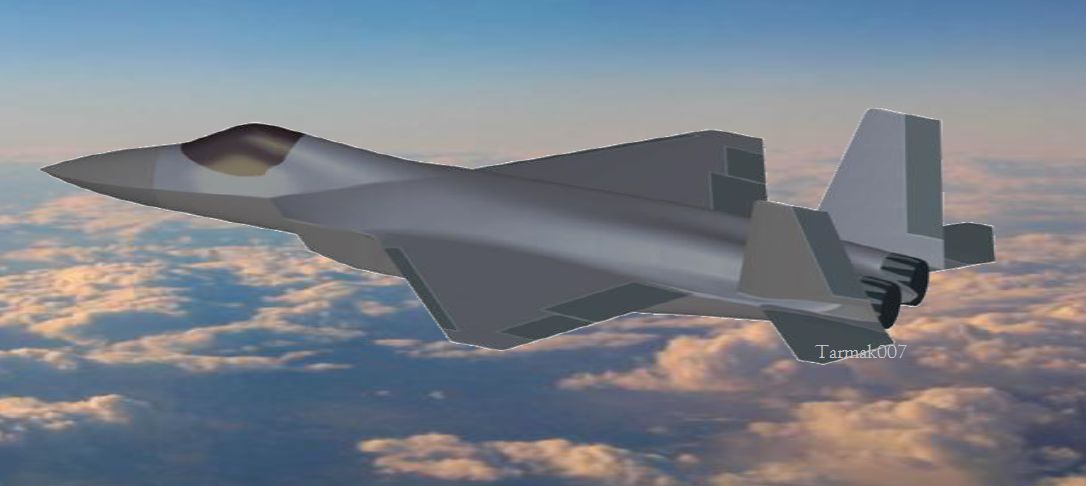

Tarmak's software generated image of the tailfin looks better than the Aero India model which I think is probably not a good representation of the original.
