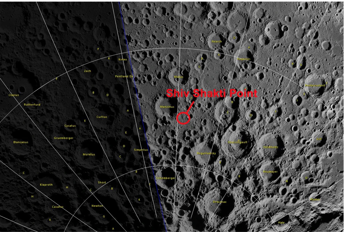

Re: Chandrayaan 3: Launch and Discussions
Chandrayaan-3 Landing Site imaged by NASA's Lunar Reconnaissance Orbiter:
http://lroc.sese.asu.edu/posts/1314
Posts: 11920
Chandrayaan-3 lander is in the center of the image, its dark shadow is visible against the bright halo surrounding the vehicle. The image is 1738 meters wide, M1447750764LR [NASA/GSFC/Arizona State University].

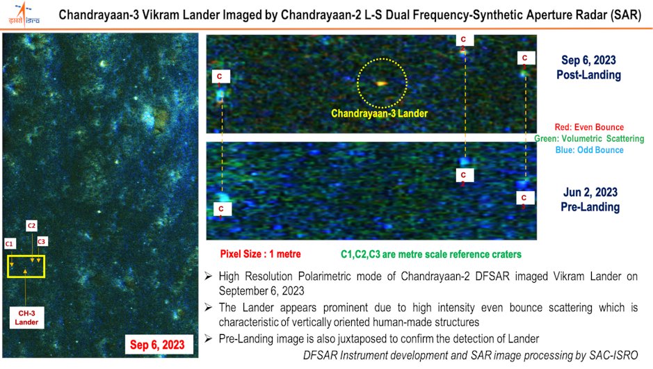

Here is an image of the Chandrayaan-3 Lander taken by the Dual-frequency Synthetic Aperture Radar (DFSAR) instrument onboard the Chandrayaan-2 Orbiter on September 6, 2023.

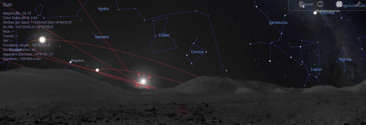

Remembering my favorite कहीं दूर जब दिन ढल जाए...
(Speeded up the day/night/day at the Vikram's place)
Enjoy:
(You can see Earth, planets, stars, and sun.. Sun set, as I posted here before on Sept 4, now waiting for the dawn)
See how the earth remains at almost the same place when stars and planets move in the background..
Click the image to see the animation..
(I know, the shadow of the Vikram does not move -- may be when time allows, it will be fun to do that.. and redo this with Mukesh's voice in the background)..
Added later: (Unlike some of my previous animations - this animation is not that mathematically accurate - produced with the help of an ordinary but popular app. Many using JPL/Horizon data are mathematically much more correct - I almost did not share it, keeping it here to to see comments. It does give some idea - how low the sun is, but directions and timing are not that accurate..For expert eyes, azimuth of earth , apparent size and brightness) are some of the things easily noticed.

^ lunar eclipse at 0:35 s ??

juvva wrote: 10 Sep 2023 11:25 ^ lunar eclipse at 0:35 s ??
Solar Eclipse brother.
When we have a lunar eclipse, moon dwellers would have a solar eclipse...

wouldn't the apparent size of earth be greater than the apparent size of sun as seen from moon?
Posts: 11920
^^^ No eclipse. And yes, apparent size of earth, and azimuth are not mathematically correct ..( Earth should be above the rocks in the left - see the drawing I posted before).. apart of static shadow of Vikram etc.. (I edited /added few more comments in the original post - please read)..
The next solar eclipse Vikram will see is on October 28...(It will be dark for a few minutes even in the 'day'..)

Amber G. wrote: 21 Sep 2023 08:03 It is September 21, 2023 (UTC- 00) -- All quiet.
Probably it is programmed so that when it wakes up and gets command from ISRO it may start sending back its radio transmission...
Posts: 11920
^^^ Not an actual realtime photo but mathematically accurate... (Sun's position is accurate over a landscape from moon's map - at the specified time)
