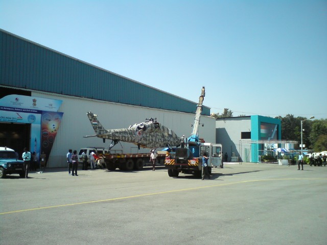

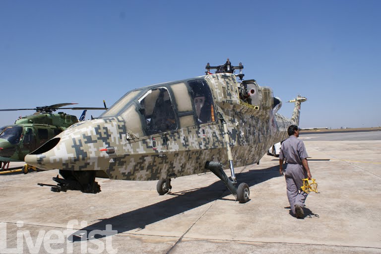

LCH TD2 in camo...
LiveFist: AERO INDIA: Light Combat Helicopter 2nd Prototype In Camo
I guess this is what Hari Nair was referring to when he talked about looking out for changes in the paint scheme, and there I was trying to figure out what the significance of the yellow primer and gray panels in the earlier photo was
Re: LCH and other Helicopters Discussion Thread
it instantly reminded of the 80s novel by craig thomas "snow falcon" about a soviet plot to invade finland and scandinavia.
http://recycledbookcompany.com/images/A ... Falcon.jpg
the camo sends a message that this bird is meant for service in the himalayas...

On the contrary, to me it appeared like it had green foreground and grayish green background to allow it to blend with the kind of foliage one sees in our arid regions..parked on the ground with that camo it will be difficult to spot from a height. Also may help it to merge with tree top foliage when approaching enemy at tree top levels.Singha wrote:it instantly reminded of the 80s novel by craig thomas "snow falcon" about a soviet plot to invade finland and scandinavia.

LCH td-2 pics on livefist.what a menacing camo, it looks ready already eventhough it is a td
first time application of digital camo on any Indian aircraft. looks awesome !

LCH TD-2 looks like a fiery beast....awesoome camo!!:twisted evil:
^ Should I call that as Snow Leopard or Snow Iguanas ? Beautiful!
Fit very much to its profile as hill rider.

Wow! Just Wow! It seems we SDREs are also adapting to the TFTA way of looking badass!
another one of the Camo'ed LCH
and yet another one.. sorry about that, will get much better ones tommorrow...
