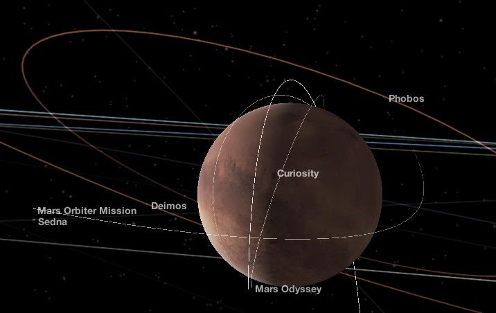

Not exactly Mars centric ( I take Mars centric is ' as viewed from Mars' surface .. it would be an arc from horizon to horizon ' ) but as seen from space NEAR Mars .. this will show the orbit shape and position. ( Generated using NASA Eyes software ).
The description is oversimplified because those who are not much into this subject can also 'enjoy' the images.
First image shows MOM approaching Mars. Note that this is not due to MOI, ( MOI is yet to take place ), but simply due to Martian gravity. 2nd shows the situation just after MOI.
Image Image
The earlier 2nd image as seen from Mars' North Pole .. notice the point of closest approach that the craft has taken around equator. Last image shows MOM in its first orbit. ( full ellipse could not be generated ). Notice the equatorial nd large MOM orbit as compared to MAVEN's polar orbit ( bright ellipse around Mars )

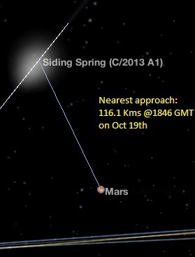

Presently SS is 128 Million kms from Mars. Its orbit which is out of ecliptic is seen in 1st image Image
Next is nearest approach to Mars
The SS and MOM are way out in directions ( Blue line shows the direction of SS ). MOM is 22000 kms from Mars
Whether imaging can be done is ISRO question.
