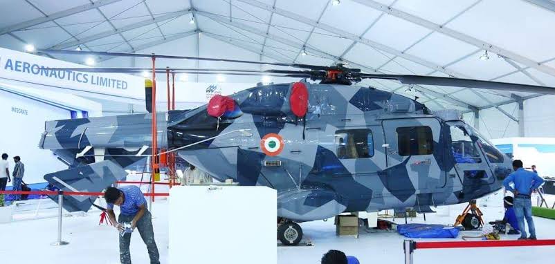

On the table is a platform that has all the requisite performance characteristcs That the nave would want with all the previous issues such as stoawbilkty and or serviceability Galen care of. The ONE issue that is really bothering me is the WEIGHT issue as it seems like it’s the last remaining hurdle that the navy may throw at HAL to prevent the ALH from qualifying.
-So we know that the navy diluted their AUW requirements from 4.5t to 5t, they haven’t publicly said why but I’ve heard the speculation that it was to give the S-76 a chance (HAL TP seemed to echo the view)
- ALH AUW is 5.75T (from HAL TP) so we are arguing over over 750KG which isn’t an inconsiderable amount of weight
- HOWEVER- and this is what has been bugging me, since when did AUW become a limiting factor? Dimensions (stowabikkty) sure, there’s finite room on a ship, we all understand that. But weight? Are they trying to say the landing pad on the ships cannot take more than 5t? That surely isn’t right (and I’ll explain why below). And again we are talking about AUW not empty weight. There’s nothing forcing the navy operating the ALHs at Max AUW. The empty weights of the Panther and Dhruv are very similar and their engines have very comparable SFC (Shakti is actually on the more efficient side to the Arriel 2X). The ALH has superior internal cabin volume sure (2 more seats AFAIK) and most of the higher AUW of the ALH compared to the Panther will be higher payload/fuel capacity.
- So what are these smaller IN ships that absolutely cannot operate a NUH heavier than 5t hence this NSQR on the RFI? The smallest ships with aviation decks in the Navy are the P28 ASW corvettes and Surya OPVs. Well the P28s are designed to operate the >10to NMRH ASWs and the Surya is explicitly designed to be able to operate the ALH and have done so in the past:
https://ibb.co/hH5R2s4
So once again, what are we exactly talking about? Most of the navy’s ships house the Sea king or are designed to, many can even house 2 of them. So it absolutely is contingent on the Navy to now justify this NSQR, if they are going to use 750KG AUW as a reason to exclude the ALH from the single largest order in HAL’s rotary wing history they had better have a good explanation. And remember the 16 ICG MK.3s on order are intended to operate from their larger ships which are still only comparable with the very smallest IN vessels. If someone can provide even a single ship currently or soon to be in IN service that couldn’t operate the ALH due to weight considerations I would be very grateful. This is just another red herring as far as I’m concerned.
And sure, with the resolved or soon to be resolved issues detractors may say “this is up to HAL promises” but what’s going to come quicker, HAL porting over designs they have already designed and validated on the LUH (segmented folding blades) or going through this entire circus of RFI—>RFP—>Trails—> technical evualtuons—> L1 selection—> cost negations—> DAC approval—> CCS approval—> inevitable delays—> contract signature—> delivery.
We are looking at at least another 10+ years before that process delivers even the first unit.
And let’s not forget this is a process the navy has been trying to get off the ground since 2011 when they get the original
Consent from HAL to go for a foreign NUH through the “buy” mechanism. And lets also not forget this is the very first of the entirely unproven SPM deals that they are trying to push so there’s an entire untested layer of nonsense that will be added to the entire process. Can this deal survive 2 general elections especially (god forbid) an opposition party comes in and starts to run amok, the first thing they’ll target is the SPM (even though it hasn’t delivered squat).
Worst case scenario it takes HAL 2 years to validate the new blade folding mechanism, it will be 3 years after that they can deliver the first ALHs so 5 years from now. If anyone actually thinks they can get a NUH quicker through the SPM process I have a bridge to sell you.
In short, forget and forgive HAL for any last sins. Assess the N-ALH MK.3 on its own merits and you’ll see it’s by far the best platform on offer and it just so happens to be indian.
Or pursue a multi-billion dollar boondoggle that won’t deliver anything this side of 2030 and have the Chetaks still serving 15+ years from now.

For “high end” IMRH ASW work, IN got the 24 Romeos. Get another 12-24. That should cover that category requirement for a long while. Use the time obtained to work on HAL-IMRH for future replacement/augmentation.
For “lower-end” NUH requirements, get the NALH MK.3 with segmented folding blades. Work with GoI, DRDO, HAL and private sector for additional customizations and PBL support.
No brainer :twisted:
Re: Indian Naval Aviation
Indranil wrote:Are we waiting for technology development or fund release?
Sounds like both when it comes to HAL NUH. Who funds R&D segmented blades (and other customization) before orders guaranteed? Last couple of years, HAL has been strapped for cash. GoI/Navy also not funding.
How ready is this? How much funding and time is required to make it ready for the IN?
Still a mock up.
