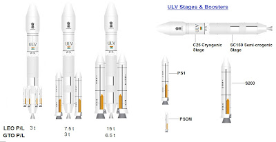

prasannasimha wrote:This is the proposed upgradation of the GSLV
Mk-IV is an old concept. There is no official ISRO source for this version. I doubt it will ever fly. And I would be happy if it doesn't.
IMO The current ISRO approach of upgrading the core stage with semi cryogenic CLC (ULV) is the better way.
The S200 boosters don't come cheap. Using 4 of them will cost a LOT. In addition to that will be costs associated with the current core (earth storable propellants used by them also don't come cheap). And we don't know if the current core is structurally strong enough to take 4 big solid boosters. The combination will cost lots of money and moreover will be a developmental dead end.
The ULV on the other hand is the logical way of upgrading our capabilities even if it takes more time. Both in terms of eventual launch costs and for developing Heavy/Super heavy launchers if the need arises.
ISRO's current plans for the future (10-15 years ahead) is something like this.
Lower end - Fully solid launch vehicle
Mid tier - ULV
Heavy - RLV / ULV Heavy
And it's a good plan. So I don't think there will every be a GSLV Mk IV, at least like the one above.

ISRO seriously needs to look at the GSLV Mk2 config. The present config is underwhelming. It has the spare capacity to take in a much larger payload to GTO.
If you look at the booster stages and the zero stage, the 4 WeakAss (Vikas) engine, burn for 160 secs, while the zero stage the S139 with a piddly specific impluse of 166s (seems an error. I picked it up from wiki) burns for only 100 secs and the 4 WeakAss engines lug that dead weight of the spent zero stage for a full minute.
The easy way out would be to S-200 booster stage from the MKIII (which puts out 5150KN) and Three improved Vikas from the L110 of the GSLV , which put out 700 KN each(or rather Not So WeakAss),all burning for approx same time of 150 secs , the S200 might need some extra propellant loading to burn for the 150s or so.
I think if that is done, and the CE-7.5 is brought upto full performance , the GSLV Mk2 would go to it's full potential of close to 3 tons or more to GTO .That improvement will come from the higher efficiency of the S200 and improve Vikas engines (they seem to have higher iSp than what the current ones have) , and also from not carrying dead weight for a full minute.
In addition, it would cost less, as you would have 1 WeakAss engine less than current and also be more reliable (one engine less to fail). I think it would be a more competitive and credible offering than the current GSLV Mk2 config.

vina wrote:ISRO seriously needs to look at the GSLV Mk2 config. The present config is underwhelming. It has the spare capacity to take in a much larger payload to GTO.

prasannasimha wrote:Vina - how conversant are you about strap on booster separation dynamics ? Also are you aware that the boosters are still attached to minimize fuel unsettling when igniting in the coast phase and is an intentional design despite recognizing that it will decrease performance and performance and has been factored in and found to compensate for that ?
:rotfl: :rotfl: :rotfl: . Unfortunately for you, actually yes.
The trouble is, before mouthing off such high faultin' stuff like "separation dynamics" and throwing in "fuel unsettling" when igniting in"coast phase" hence calling it "intentional" etc , you should have considered if you what you said actually made sense or just so much gibberish dusted with some nice phrases.
For eg. slosh (the correct technical term) is a problem with liquid engines only ? Why because liquids have a free surface and transverse moment of inertia lowers stability. The problem doesn't apply to solid engines (in rockets).. Why ? Because the solids are cast solid and can't move (if they are in powder form/granular form like say grains or granules, then there is a slosh problem and you have to analyse them like liquids.. for e.g., a plane or a ship or a truck carrying liquids, grain, coal etc will have stability problems due to free surface).
Specifically for GSLV MK1&2, the core solid is spent at 100s and the liquid boosters keep firing until 160s. You cannot drop the dead mass from the core stage, because it is in the middle and the boosters are attached to it! Sure it is intentional, for a different reason and I will tell you in the next part.
Do you really think that you can easily just mix and match these stages so easily.
And pray why can't you ? The entire GSLV Mk1/2 and it's sub optimum config is due to mix and match.. See, the GSLV was realised "cheaply" by reusing the PSLV stuff. The core stage of the GSLV is the core stage of PSLV, the boosters are the 2nd stage of PSLV. The reason why the GSLV carries the spent core for 60s, is precisely because they didn't engineer a separate core stage for the GSLV MK1/2.
The MKIII is a clean sheet. That is why the config is cleaner. The thing now, is you have better /more suitable components to come up with a cleaner MK2 from the MKIII, rather than from the suboptimal ones from the PSLV, so why not do it ?
Actually, the MKIII and the MK2 give components that can replace the PSLV (which is a complex vehicle 4 engines in all, though very reliable) with a more compact, efficient and reliable version..

A lighter GSLV would also do good, like a TSTO option of a single S-140 and CS15(CE7.5) would be lobbing a 1.5 - 2 tonne satellite to GTO. It would be in the same lines of PSLV-3S which ISRO was planning, replace the two upper stages with cryo and you would get this
A S200 and CS25(CE20) would also do good

For eg.. The base GSLV MKIII for a 4 ton to 5 ton GTO has a lift off mass of 660 tons (a mass fraction of 0.7% or so), and it is a 3 stage vehicle to boot. A base Atlas V with a similar 4 to 5 ton GTO has a lift off mass of around half of that at just 330 tons (a mass fraction of 1.5% or so, double that of GSLV MKIII) and the Atlas V is a 2 stage vehicle ! The Atlas burns kerosene (dirt cheap, okay special grades albeit) from refineries, while the GSLV burns up gargantuan amount of solid propellants and carcinogenic UDMH and N2O4 which needs special plants to produce it and require special hazmat handling.
ISRO desperately needs the LOX/Hydrocarbon stage ASAP. All efforts and funds should go into that. This manned space flight thingy is just a whole load of baloney and a distraction. Hand it to NASA and the Chinese and focus on what you need to get.
