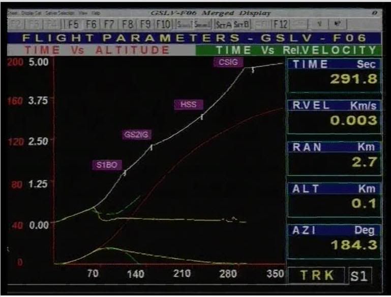

Good show ISRO. From the video KrishG posted, things were fine till the explosion at the top..

Re: Indian Space Program Discussion
A better quality graphic of last momenta is reproduced here.
Presently without comments.

My initial quick comments:SSSalvi wrote:A better quality graphic of last momenta is reproduced here.
1. Veering off the trajectory noticed prior to S1BO (Stage 1 Burn Out)
2. It could be a control error to the Stage 1 Motor (or)
3. It could be a control error in the LSP Motors (one of them misbehaving)
If pt. 2 above: extremely freak., since the Stage 1 Motor has been tested thoroughly in several GSLV Flights
From past pt. 3 likely.
