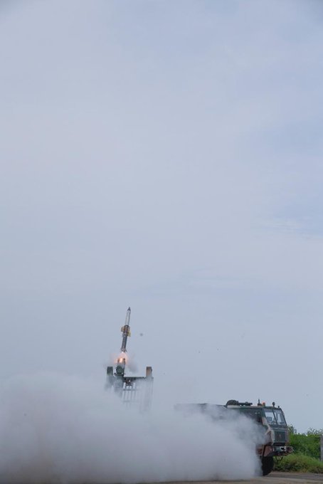

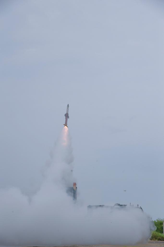

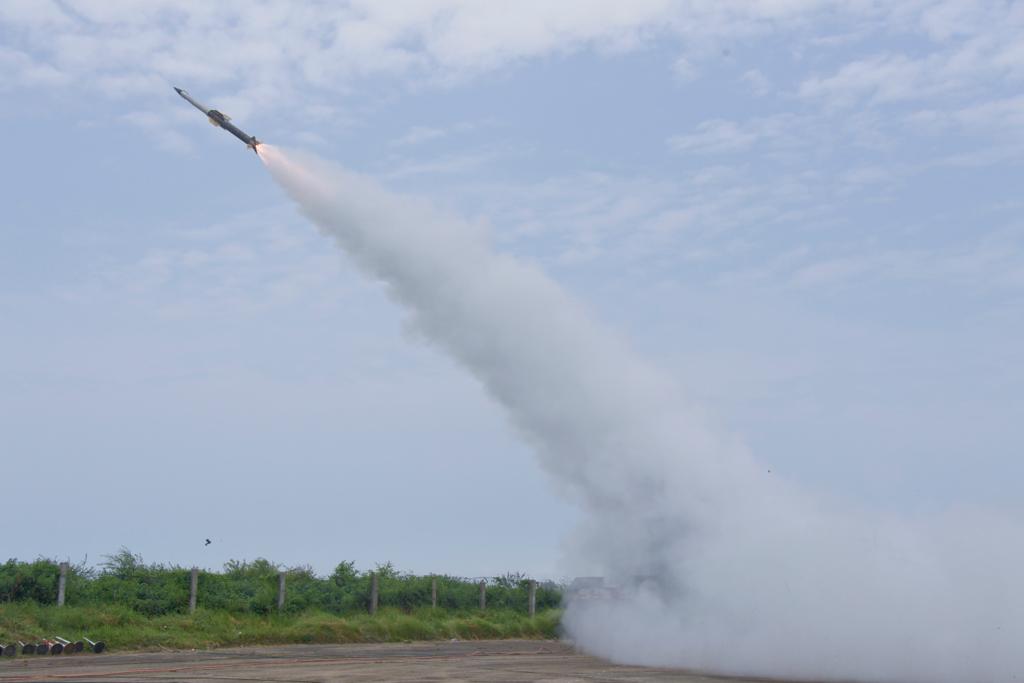

India test-fires Quick Reaction Surface-to-Air Missile
https://economictimes.indiatimes.com/ne ... 520608.cms
https://twitter.com/writetake/status/11 ... 0248347648
2 QRSAM missiles tested against live targets successfully today, say defence sources.
https://twitter.com/SpokespersonMoD/sta ... 8422108160
@DRDO_India developed state-of-the-art Quick Reaction Surface to Air Missiles (QRSAM) have been successfully flight tested against live aerial targets on 04 August 2019 from ITR, Chandipur.
https://twitter.com/DefenceMinIndia/sta ... 0675981313
https://twitter.com/i/status/1157988780675981313
The link has Video of the testSuccessful flight testing of state of the art quick reaction surface to air missiles (QRSAM) against live aerial targets on 4th Aug 2019 from ITR, Chandipur.

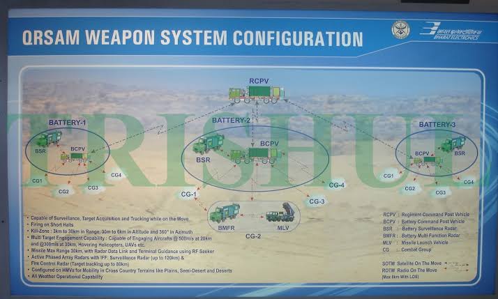

QR SAM is going to have slant launcher ??? Cna it operate on a battery or group
prabhug wrote:QR SAM is going to have slant launcher ??? Cna it operate on a battery or group
