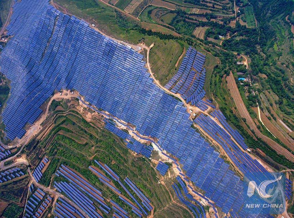

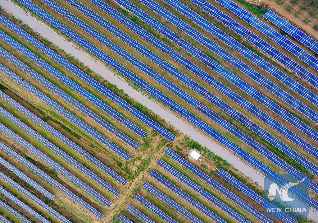

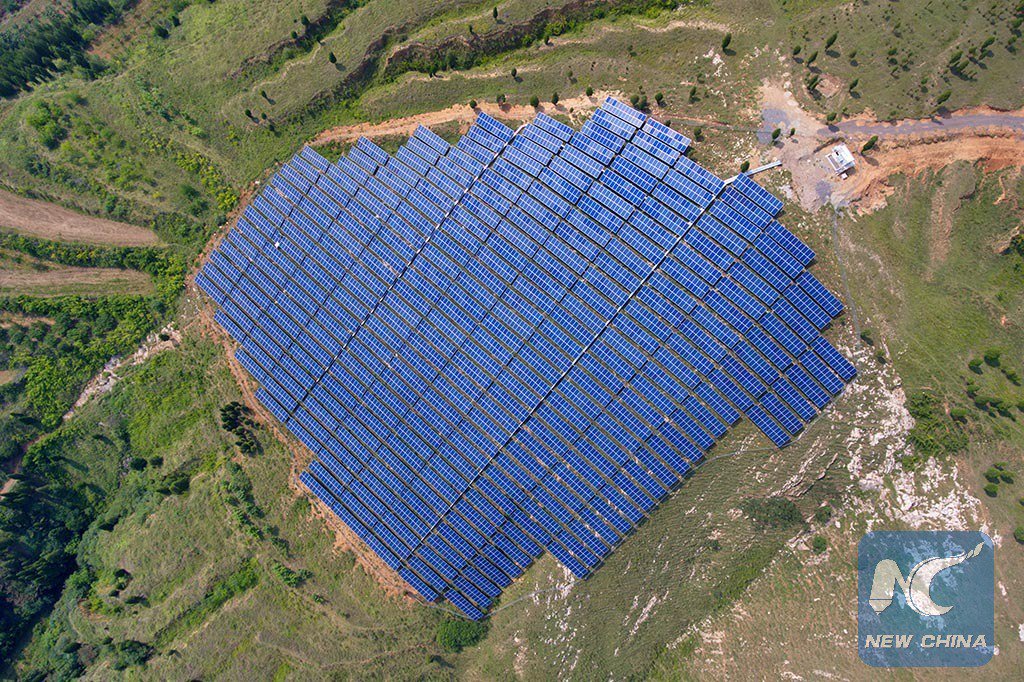

take a look at what the chinese are doing and we are still mired in the land acquisition bill and its fallout.
twitter
More photovoltaic power plants are built on barren mountains in N China's Shanxi to help locals increase incomes
