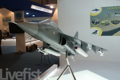

Re: LCA News and Discussions
Paging gurus.
I was looking back at some of evolutionary features from Rafale A to Rafale M.
Here is pic of the Rafale A:
Image.
Notice the similarity of the wing and the lower wing body join in the LCA.
Now my question is the Rafale significantly smoothened the wing body join to:
1. to improve transonic drag
2. reduced RCS
3. increasing the internal volume significantly
Rafale M now looks like this:
Now my question is:
The wing body blending on the top of the LCA is fabulous. What about the bottom part? It looks very sharp to me. Why not blend it too? It makes even more sense now with the lengthier MkII.

^^ In LCA, engine openings are little behind and below the wings. In Rafale, engine openings are placed ahead and below the wings. In LCA, to merge wings endings into fuselage(lower part of aircraft), engine tubes have to be pushed towards front upto the point where wings start. It will take whole redesign than just smoothening.
Actually, its not smoothening. In rafale, they have 'merged' wings with engine tubes on upper and lower sides. This technique of designing an aircraft as one integrated single continous block, with no breaks(where wings don't appear separate from body as in LCA, Mirage, Su-30), is similar to method used in F-22. This is new and different design philosophy from those used in earlier generation planes. Only Russia is doing now same thing in Pak-Fa and even China's J-20 uses same philosophy, where body and wings appear as single entity, not separable parts when integrated!

isnt gripenNG doing same now to accomodate pushing out the landing gear and creating internal volume for fuel ?
even the ancient saab draken had this look http://www.flugzeuginfo.net/acimages/sa ... ldrage.jpg

^^ yes, that's more that type of thinking there... have you seen those IL-76-stuff? ..see how wings end up nicely into a thick beam joining them into main body... wings seems to disappear/merge into main-body nicely, it airflow doesn't find air-pockets in such design and merely slides over the body areas... let's hope AMCA brings a huge change in our designers approach and we don't repeat some Su-30 type of thing.
raajneesh wrote:^^ In LCA, engine openings are little behind and below the wings. In Rafale, engine openings are placed ahead and below the wings. In LCA, to merge wings endings into fuselage(lower part of aircraft), engine tubes have to be pushed towards front upto the point where wings start. It will take whole redesign than just smoothening.
Why do you have to merge the wing with the air inlet when they are not matched. Smoothen the join from the diffuser along the wing join.
It looks fairly simple. And no it would not involve a lot of testing.
There are questions about wave drag (which is am issue in MK I). There are questions about fabrication but not about a huge redesign.
raajneesh wrote: Actually, its not smoothening. In rafale, they have 'merged' wings with engine tubes on upper and lower sides. This technique of designing an aircraft as one integrated single continous block, with no breaks(where wings don't appear separate from body as in LCA, Mirage, Su-30), is similar to method used in F-22. This is new and different design philosophy from those used in earlier generation planes. Only Russia is doing now same thing in Pak-Fa and even China's J-20 uses same philosophy, where body and wings appear as single entity, not separable parts when integrated!

^^ Can you show some example of what exactly you want to achieve by smoothening?
LCA and rafales are based on two different design philosophies. A jugaad type of smoothening won't be effective. Its far more sophisticated stuff. Things has to be done at design stage, for that.
Rafale is whole 1 generation ahead in that respect to LCA. Its comparable to F-22, J-20, Pak-Fa in terms of its airframe design philosophy, except one thing - no internal weapon bays. Later 3 takes the cake and are far more complex.
I think French have tried to test some of their 5th Generation UCAV airframe manufacturing/design technologies into this rafale design.
Singha wrote:isnt gripenNG doing same now to accomodate pushing out the landing gear and creating internal volume for fuel ?
No it is not. Gripen always had a wing well blended in.
In Gripen NG, they actually actually made join like a bulb. They moved the main undercarriage housing mostly into this bulb. This freed up internal space for fuel. However the blending was always there.
Actually we expected something similar on the Tejas MK II. The undercarriage in MK II is going to be different. But I couldn't see a major difference in the models (other than small humps) showcased in AI '11.
