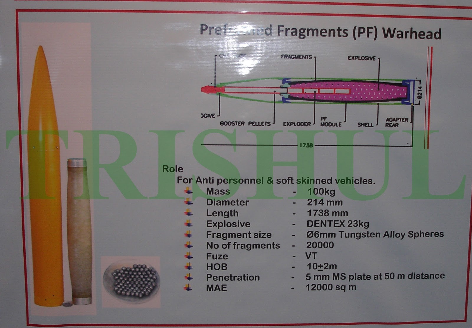

Pinaka warhead. 20,000 tungsten ball
http://3.bp.blogspot.com/-OARe91BtuHQ/U ... MBRL-4.JPG

Karan M wrote:Pinaka warhead. 20,000 tungsten ball
If you note the tungsten is half the dia meter of the steel balls (6mm vs 12 mm). Density of tungsten is ~2.5 times steel. So makes up the diameter diff.
Also Newton had proved depth of penetration is proportional to density of penetrator to target material other things being constant. IOW denser the penetrator the better the depth of penetration.
Also there was an expert at MBB, Dr. Maximilian Held who showed spheres have best depth of penetration vs cubes or jagged fragments. Because uniform surface area of sphere assure reliability of penetration. Jagged edges cant be sure of contact aspect ratio.
Henry Shrapnel also used spherical shape for his famous shell.
Re: Su-30: News and Discussion - August 9 , 2014
ramana, it makes sense. A non-spherical projectile will lose energy lot more rapidly while tumbling thru air.
