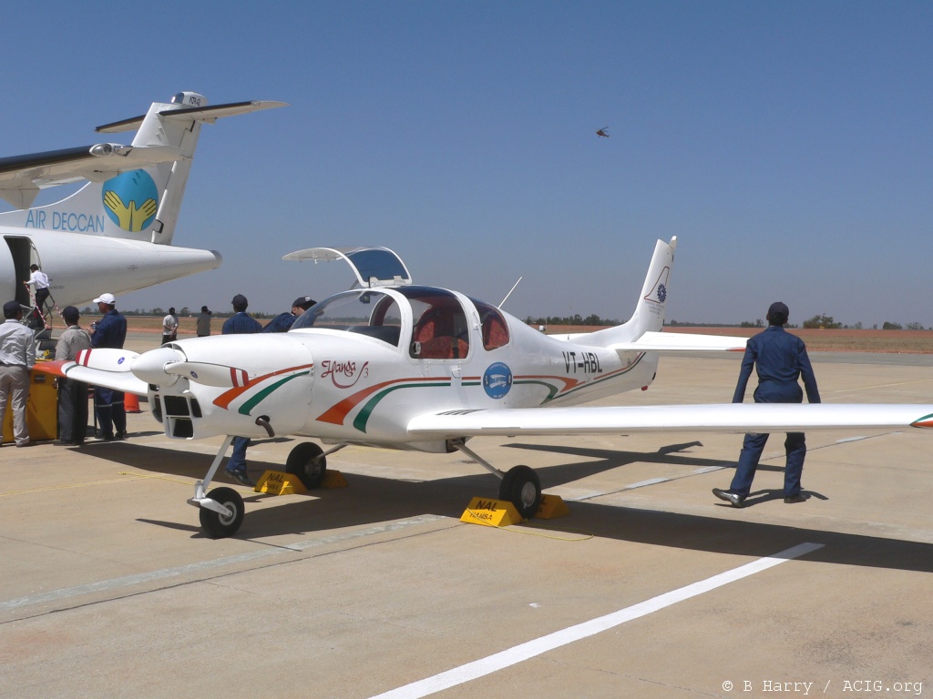

India signs deal for 194 micro-light planes with Slovenian firm
Read more at:
what happens to hansa?
Can anyone compare the performance between the two?
Gyan
Posts: 1183
Post by Gyan »
Imported maal is always the best, so say Swiss bankers!
ManjaM
Posts: 1217
Joined: 15 May 2010 02:52
Location: Padvaralli
Post by ManjaM »
Please. Lets not go full CT when there is a better explanation.
1. DGCA defines microlight as <450kg all up weight, Hansa3 is not a microlight.
2. The Hansa 3 has a Rotax 914 turbo with fuel consumption (> 10 gal/hr for turbo) close to double that of the Rotax 912UL which powers the Pipistrel(5.3 gal/ hour normally aspirated).
3. Pricewise Hansa3 is more than double the cost.
4. Hansa3 has a constant speed prop whereas the Pipistrel has a fixed pitch prop.
5. In any case, you cant replace a microlight with a turboprop no matter if they look the same. Firstly, you will not be allowed to go to a complex aircraft straightaway. Secondly, if someone were to try it, the added complexity of the turbo and the variable pitch prop will certainly overwhelm novice pilots causing them and their instructors untold grief in the cockpit.
Currently, the only Make in India alternative to the Pipistrel would have been the X-Air F series or the Zenith Aircraft CH750. X-air F is already in service with the NCC for similar operations. I dont believe Zenith can deliver 194 aircrafts in 3 years. I have seen their plant. It is a great company with an excellent STOL design, but they would be hardpressed to scale to this level.

Can the u-light planes be converted to UAVs if good Control Systems are devised?
vayu tuvan wrote:Can the u-light planes be converted to UAVs if good Control Systems are devised?
Would make a stealthy Kamikaze bomber.
That's what Kadet systems said they would do with the Hansa aircraft, and you all laughed them off.

Kadet and NAL were speaking of an UAV.
They will probably keep the wing (just extend it), landing gear, control surfaces, engine and fuel systems. They will change the fuselage and change the orientation to a pusher configuration. People are hung up on how a plane designed to carry humans is not optimally shaped. That is not a challenge. Challenge is in building subsystems.

vayu tuvan wrote:indranilroy: It should be possible to design a fuselage through modification of the air-frame and two versions of control software (but same microcontroller/computer) to have multi-role Hansa. One base platform but dual usage - manned craft and unmanned UAV. For unmanned UAV, the pilot's weight can be used to put in more computational power; 70-80 KG processing power is enormous now a days.
"Area-Efficient VLSI Computation" is a classic - CMU PhD thesis of Charles E. Leiserson.
It is not he weight. UAV's fuselages are completely packed from inside to have the most streamlined body possible leading to longer loiter times.

Karan M: Those two have same DNA as Hansa/Hamsa?
indranilroy: So the air-frame platforms are not compatible?
(both questions are Socratic in nature, just in case you two think I have some super duper gnyan on these thingummies)

vayu tuvan wrote:Karan M: Those two have same DNA as Hansa/Hamsa?
NAL is the creator/originator of both airframes.. so in a sense, you are correct.
They are most certainly compatible, but a purpose built UAV will be cheaper to operate.

vayu tuvan wrote: indranilroy: So the air-frame platforms are not compatible?
Not compatibility, but efficiency. Let's say you design a plane which can be flown by humans and serve as an UAV interchangeably. Let's also say that you can remove every thing that caters to humans from the plane when it is to be used as an UAV. But the plane which can seat two humans abreast has to have a cabin which is i approximately 1.5m wide, 1.2 m tall and 1 meter deep. When the plane flies you have to push the air around these dimensions.
Now, imagine you were designing a UAV subsystems to have a 150 kg payload. The fuselage doesn't need to be any wider than the engine. A 100 hp engine is about 0.6 mtrs wide. You can actually fill up the entire subsystems weighing 150 kg in a cylinder with 0.6 mtr diameter with a depth of about 1 mtr. So you design your UAV fuselage as a cigar (for best aerodynamic efficiency) with a diameter of 0.6 mtrs. Put the engine at the back, so that the spinning props don't interfere with view in the front (primary FoV). Put the equipment in a bay in the front to counter-balance the engine weight. Put a whole lot of fuel in the middle, so that the CG doesn't move much as the fuel gets used. Put the fight controls between the fuel tank and the engine, leads to least amount of control wiring and lines. And there you have a good balanced design, in fact the general layout for most UAVs out there.
vayu tuvan wrote: (both questions are Socratic in nature, just in case you two think I have some super duper gnyan on these thingummies)
I am an enthusiast as well with a very keen interest in aerodynamics. Unfortunately, it did not materialize into a career for me.
Posts: 14494
Nice lucid explanation. Thanks guys.
