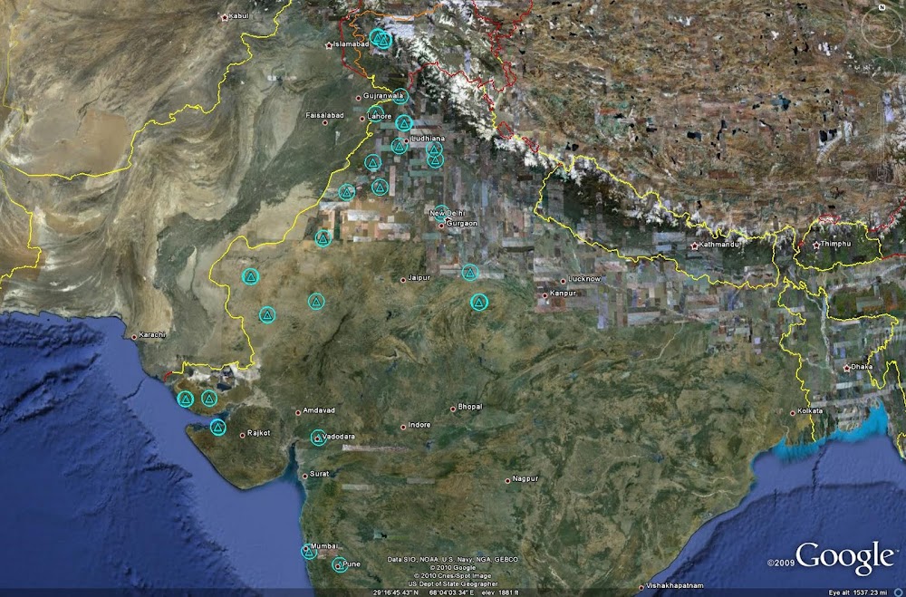

A good analysis of Indian SAM Network is here (2010). Good starting point since Akash would most likely fill in the void left by retiring Pechoras.Akshay Kapoor wrote:Guys I would love to do a analysis of where the these IAF Sqdns would be stationed. But purely wiki analysis of logical areas, no classified info or chaiwalla please. We know the first two are at Pune and Gwalior.
IMINT & Analysis: The Indian SAM Network
24 Pechora Squadrons deployments shown below. Note there are no deployment in the NorthEast!
Likely Akash Squadrons (2 + 6 + 7) deployments ... following Su-30MKI bases:
West
- Pune (widely reported) -> Su-30MKI base; would have replaced Pechora deployed there
- Gwalior (widely reported)
- Halwara (likely) -> Su-30MKI base (would replace Pechora)
- Sirsa (likely) -> Su-30MKI base (would replace Pechora)
- Bhuj (likely) -> Su-30MKI base (would replace Pechora)
- Bhatinda (likely) -> Su-30MKI base (would replace Pechora)
- Ambala (likely) -> planned Rafale base (would replace Pechora)
- Tezpur (likely) -> Su-30MKI base
- Chabua (likely) -> Su-30MKI base
- Hasimara (likely) -> planned Rafale base

srai wrote:A good analysis of Indian SAM Network is here (2010). Good starting point since Akash would most likely fill in the void left by retiring Pechoras.Akshay Kapoor wrote:Guys I would love to do a analysis of where the these IAF Sqdns would be stationed. But purely wiki analysis of logical areas, no classified info or chaiwalla please. We know the first two are at Pune and Gwalior.
WestNorth-East
An excellent starting place
But outdated. Not changed since years
ALL he bases in north and west but NONE in east have SA 3 batteries.
As of now I have located Akash batteries at Gwalior and Pune only
