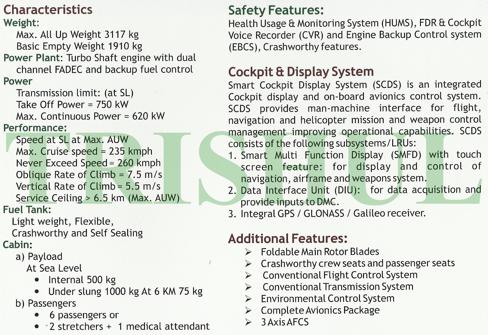

vivek_ahuja Sir,
The basic empty weight of HAL LUH is 1910 Kg and MTOW is 3117 Kg as per info board shown in AI-2015.
Can you please add the analysis for wheeled version of HAL LUH whose empty weight can be estimated to be 2025 Kg (115Kg higher than skid version) as this will be offered to Indian Navy.

HAL LUH is in the class of Bell 429 whose empty weight is 1925Kg and MTOW is 3175Kg and not Bell 407 whose empty weight is 1221 Kg and normal TOW is 2268Kg while max with sling load is 2700Kg+.
The figures can be expected to be accurate as with sling load MTOW for HAL LUH may be 3600Kg which is not disclosed so far.

HAL's Light Utility Helicopter
Slide on HAL LUH
Power
Transmission limit:(at SL)
Take off power=750 kW
Max. continuous power= 620 kW
Payload
At Sea level
Internal= 500Kg
Underslung=1000Kg
At 6Km 75Kg
Service ceiling>6.5Km (max AUW)
Vertical rate of climb 5.5m/s
Oblique rate of climb 7.5m/s
sankum

With underslung 1000kg load HAL LUH MTOW will be 3600Kg.
sankum wrote:Image
Thanks.
sankum wrote: HAL's Light Utility Helicopter
Slide on HAL LUH
Power
For comparison, the transmission limit for the Ardiden/Shakti 1H1 powering the Dhruv is:
Take off power=741 kW
Max. continuous power= 650 kW
