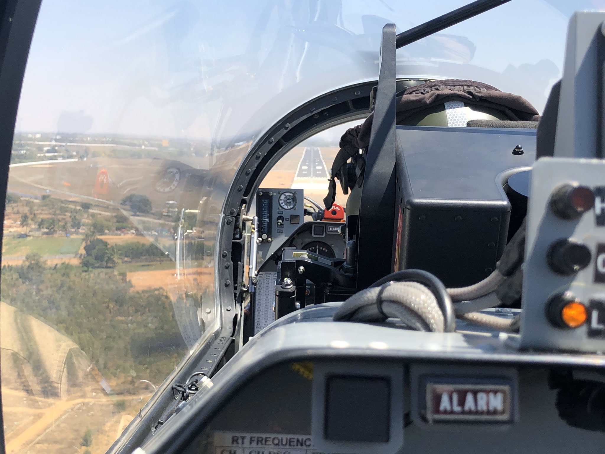

https://twitter.com/zone5aviation/statu ... 83328?s=20 ---> Runway in sight for the HTT-40. Defence Acquisition Council today cleared procurement of 106 of these basic trainers for the Indian Air Force. Pictures from a flight last year with HAL’s Group Captain KK Venugopal (retd).
