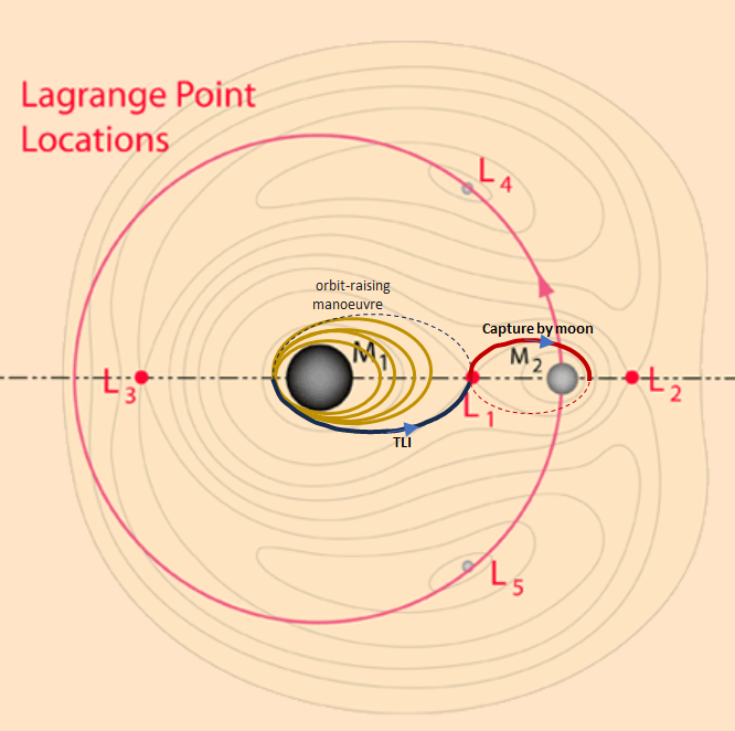

S^3 , I am not very clear. here is a plot of Lagrange Points of the Earth-Moon System.
so what you are saying is CY3 during TLI, will be pushed to L1 and further just a nudge to orbit the moon? which means during TLI it is just a huge ellipse whose perigee apogee matches with L1.
is my understanding correct?

In case of Earth-Moon pair The L1 distance from earth centre is 323050 Kms.( 316672 kms above Earth. )
For TLI orbit Apogee is 362000 kms, way beyond L1.
Moon is away when CH3 is in the Apogee. In fact the CH3 is moving away from Moon initially. But its speed is more so it comes towrds CH3.
As time passes, Moon comes near CH3, pulls the Ch3 towards it ( ie reversing of CH3 direction of movement ) and soon CH3 enters in Moon orbit about 18000Kms X 200 Kms.
This ppt tries to emulate the movement .. I could not ( yet ) been able to create the orbit around moon so celetial movie could not be generated.
https://youtu.be/qP4eu72ptNM

madhu wrote: 21 Jul 2023 14:08
SSSalvi wrote: 21 Jul 2023 17:35 Moon is away when CH3 is in the Apogee. In fact the CH3 is moving away from Moon initially. But its speed is more so it comes towrds CH3.
if green line is CY3 then it has to move reverse its direction which means we need more fuel and not efficient. more over even the video above at ~2.10min shows that CY3 keeps moving forward as i have shown.

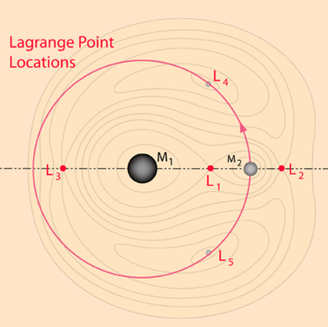

Madhu: your diagram above assumes that all the orbits (around earth and the moon) happen in the same plane. I think this may not be exactly right becausethe CY3 orbit around the moon is about its poles (and moon's axis of rotation is generally parallel to earth's axis, but not exactly. The exact angles can be googled but they are not 90 degrees apart)

Yes my diagram is highly simplified also not considering time. The main point is to discuss efficient path as I could not understand S^3 diagram. My understanding is to approach L1 such that forward movement will be in polar orbit of moon. My point is moving from leading edge is more efficient than trailing edge.

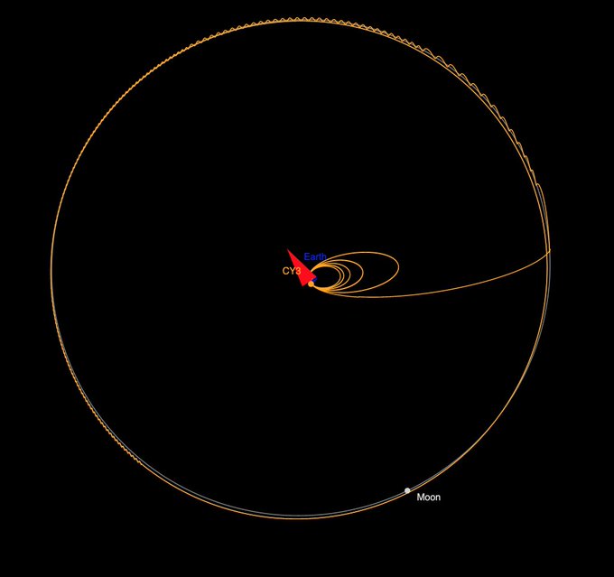

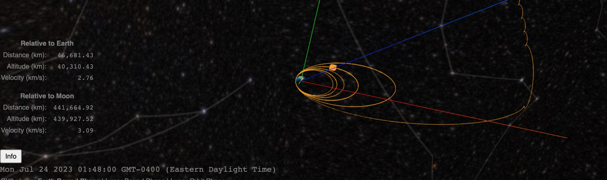

https://sankara.net/chandrayaan3.html
A nice 3d fine grain rendering by Shankar brings out the details ( My diagram is a coarse rendering. )
The inflection due to Moon is clearly seen.

To summarize, with CY3 moving away from 5th orbit apogee, the capture of CY3 in moon orbit happens somewhere in the range of 20000 to 40000 km above the moons surface?
You are on dot!

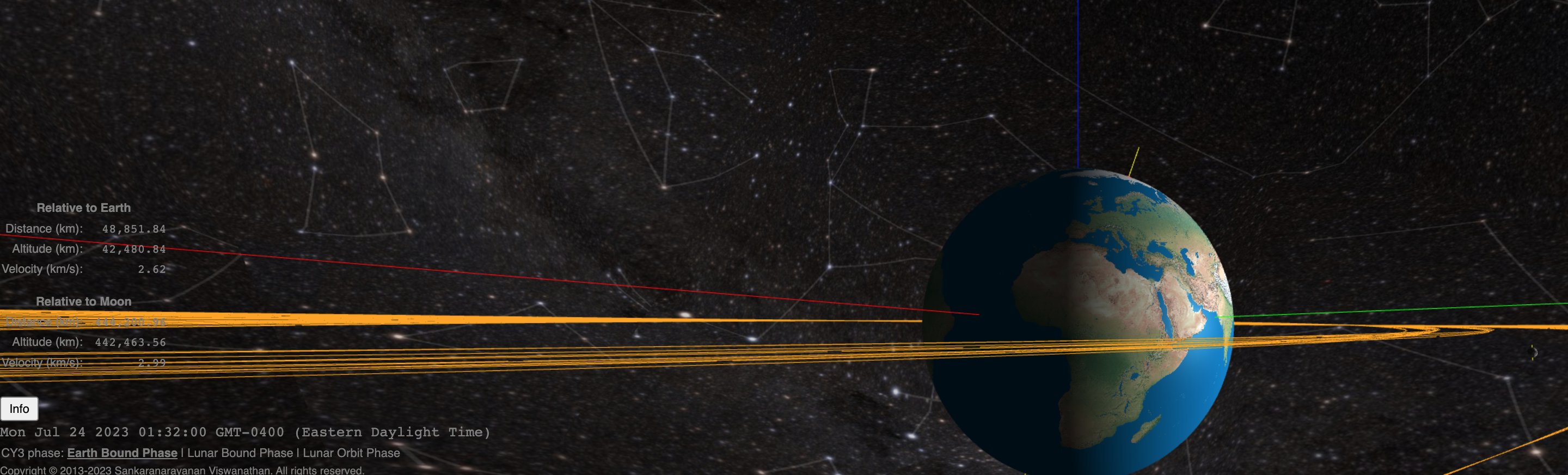

CH3 moves in Last earthbound orbit upto 30000 kms from Moon. Orbital velocity is already as low as about 0.2 kms/s because CH3 is at Apogee.
Now even a small tug from Moon is sufficient to pull CH3 in its direction. And .. that exactly is what is seen.
Ch3 was moving along last apogee from Left to right in the view seen in last diagram.
Then because of pull by Moon, the velocity reduces and after a momentary 0 it reverses and starts increasing.
It is a treat to watch distances and speeds being displayed at Left Bottom of window.
A mistake in timing and distances could throw CH3 to surface of Moon or in a very large Apogee orbit.
You could see a last correction ( a kink in the path after Perigee near Earth ) in TLI orbit to manage these conditions.

SSSalvi wrote: 22 Jul 2023 09:38 https://sankara.net/chandrayaan3.html
[[/img]
Thanks for posting this. Very impressive piece of work...a service to the public. Wonder where he got the trajectory data. The level of detail is amazing, the lunar axis is shown, as is the approaching moon. Effectively, ISRO will bring CY3 in front of the approaching moon and essentially 'park' it there in its path (zero velocity for a brief period of time). With this approach (both figuratively and literally speaking), CY3 can be placed into any orbit about the moon in any plane they want, using only small thrusters to adjust the orbit, but this needs a high level of precision in placement and timing of the 'placement' of CY3. ISRO could have taken a different strategy....wonder why this one was chosen (to come to zero velocity).....maybe its allows them to reset/calibrate the velocity instruments, and perhaps gives them more control over CY3's movement.
ISRO ( and for that matter all responsible Space operators ) posts planned trajectories ( at least for non standard Launch activities ) on NASA's Horizons data base.
https://ssd.jpl.nasa.gov/horizons/app.html#/
Upto Launch full program was available ( even Lander activities ).
But, post Launch only the realized data is available. ( e,g, presently data available only till next correction ).
Because it is purely scientific data , only enthusiasts wander that heaven.

Coming to the image, think of the lines as contour lines on a terrain map. One will get concept of the Earth's gravity well and within that the Moon's gravity well.
Put it this way, take a sand box and make a wide bowl into it and take a big blue marble called Earth and put it in the center of the bowl. Think of that as the Earth's gravity well. In that gravity well (The sand bowl), create another smaller sand bowl. Let's say at 2/3rd the distance from the Earth. In that smaller bowl, put a white marble called Moon and it is the moon's gravity well.
Here C3 is a bead that circles around Earth several time, at each circle, it is trying to reach the edge of the Moon's gravity well, such a way that at one point it will just have enough momentum that it will fall into Moon's gravity well and then start circling around the moon.
That's one way to visualize it.
Another way is to look at the 3D link of above and rotate it such a way that the RBG axis are orthogonal to each other. At that point you are looking top down (or bottom up) to the Earth-Moon system.
Now visualize yourself as a chef who is throwing rumali roti called C3 up towards the moon. Each time you are imparting some velocity for it to reach it higher and higher and at one point it reaches just high enough while the moon is ahead of it that while falling down the roti (C3) starts falling towards the moon. That is when C3 is captured into Moons' orbit.
The way kids need to be thought is via the sand models above or by visualizing Sun and other planetary bodies in a vertical stack (Sun at Bottom, Neptune at top) and show how one can launch sats to Mars by throwing the sat up and up and then get it captured into the Mars' orbit. And do the same for Earth-Moon system.
This will also help visualize what happens if Earth' suddenly looses gravity. We will be all superhumans hurtling down (or up towards Sun).

The data plotted on https://sankara.net/chandrayaan3.html is from Horizon- a JPL website which received data from ISRO. The level of detail is extra-ordinary and could have come only from ISRO or completely made up (which is less likely given that they have data for past ISRO missions- CY2 and MOM, and not been debunked).
The CY3 TLI trajectory clearly places it well beyond the L1 point and right in the middle of the moon's orbital path around earth, and in fact, a little past that. It gets to this point before the moon gets there. The moon, at this point, is still quite far away and has not yet reached the rendezvous point. As moon gets closer, it pulls CY3 towards itself in the process, negating its forward velocity (already very low) and then pulling CY3 towards itself with ever-increasing velocity permitting it to orbit the moon.

Horizons is a sophisticated and accurate astro calculator.
You could get output even upto 0.5 sec interval. It is your choice. All scientific and authentic.
Shankar's ( or mine ) graphics were made days before CH3 was launched and they are accurately matching with actuals.
I had made several educational blogs in almost real time during MOM ( Mangalyaan ) to make common man aware of science ( and to remove misconceptions - even now some said India takes a month while other countries take much less to reach Moon ).
Sharing a few images made using output generated through Horizons:

Amber G. wrote: 23 Jul 2023 11:11 so CYII has to do some major change in orbit inclination once it starts orbiting the moon.
Near Left Bottom in TLI orbit
SSSalvi
Posts: 787
Joined: 23 Jan 2007 19:35
Location: Hyderabad
Re: Chandrayaan 3: Launch and Discussions
Post by SSSalvi »
Amber G:
FRom Shankar animation. Left Bottom corner.
Already incorporated in planning ....
Plus the fact that 1st orbit is huge and is reduced by the time 2nd orbit starts.
Posts: 12894
Tanaji wrote: 23 Jul 2023 18:18 Amberg:
What does the red triangle indicate in your pictures?
Direction towards z-axis (North)
(CYIII's orbital plane is tilted wrt to ecliptic (or Earth's equatorial plane). It is approx same as moon's orbit around earth)
Sankaranarayanan Viswanathan calculations gives projection (or 3D) on any plane)...
Waiting for looking out and see something like this in a few weeks...
HT: S Viswanathan
Posts: 12894
Sankaranarayanan Viswanathan have updated #Chandrayaan3 animation. This is to match with the most recent version of orbit data from JPL HORIZONS. This is dated 21st July and extends, (I think) up to 8th August. Lunar orbits beyond that time will depend on the new data....
New addition is stellar sky background .. from NASA data so star image (with a constellation outline image) is realistic
HT: S. Viswanathan,
