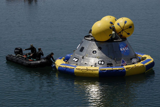

One a cone down landing is not desirable as a blunt edge will allow maximum aerobreaking (blunt body concept) (It is not a missile though SRE1 may have been used to get some data for that).
The landing should be such that the Vyomanauts should be lying on their backs as this provides least stress to the spine and other organs during deceleration
Egress from the capsule and possible drowning will be higher if there is damage to the capsule in a cone down configuration with the astronauts below the water line.
One thing that I gleaned is that the flotation collar is added after landing by the divers around the capsule to stabilize it during the retrieving of the crew and only buoys (the orange balloons in SRE1 or the yellow ones in Apollo are deployed to keep the re ascent after splashing vertical. There are photos of divers applying the flotation collar to ETF1 of the Orion capsule experiment that was done recently.

Flotation ring being applied to the ETF1 Orion capsule

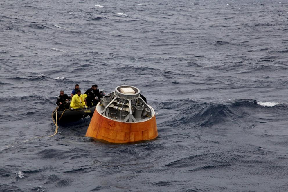

Indian coast guard recovering the capsule

Re: Indian Space Programme Discussion
Shows integration of various parts of the care module
