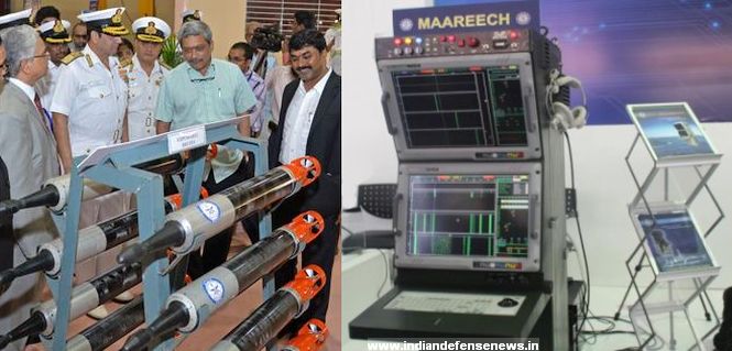

another tidbit folks...this time from a pan wala who was earlier a chai wala...
you all know about the recent decoy system was handed over to the Nau Sena.
In the end user's own words - compared decoy to decoy, this is far superior to the WASS C303 which they already have.
in fact its "decoying" performance was so good that the users actually were ready to accept it even though a subsystem of the overall system was still being proofed. Its been 18 months since then and now the subsystem in question is also working wonderfully. Overall its quite an effective system which will play a part in diluting the sub surface numerical superiority our eastern neighbour has.
People would have read in the media recently that two production grade systems were handed over. These , the chai wala thinks will be integrated to work with the ACTAS systems being imported. During and after the integration, user doctrines will be fine tuned & honed... watch out bad guys...!
May actually become a "compulsory" system on all major active and future combatants.
Super info Raghava, keep the tidbits flowing.
BTW it looks like the Mareech has its own integrated towed array sonar, so it can work even on ships without a dedicated ATAS.

Yes Karan M sir,
It will. In fact, Maareech also has an "Only - Hull Mounted Sonar" mode.

It would be interesting to see the level of Naval Involvement in the D&D of this product....

This is the sort of thing that can be used on the lightly armed Saryus in numbers! A network of such ASW nodes during wartime gives much better situational awareness than the ever popular "heavily armed corvette with 500 extra brahmos towed around in a rubber dinghy, just in case". Once a sub is tracked, other more capable (costly) assets can be efficiently deployed to hunt it down.

I think some level of ASW should be defacto on every IN/CG ship being produced. How is Abhay coming along? Wasn't that meant for patrol boats?

What was the R&D cost for Mareech? Do we know cost of manufacture is? Also what is the cost of a similar system from a foreign vendor?
