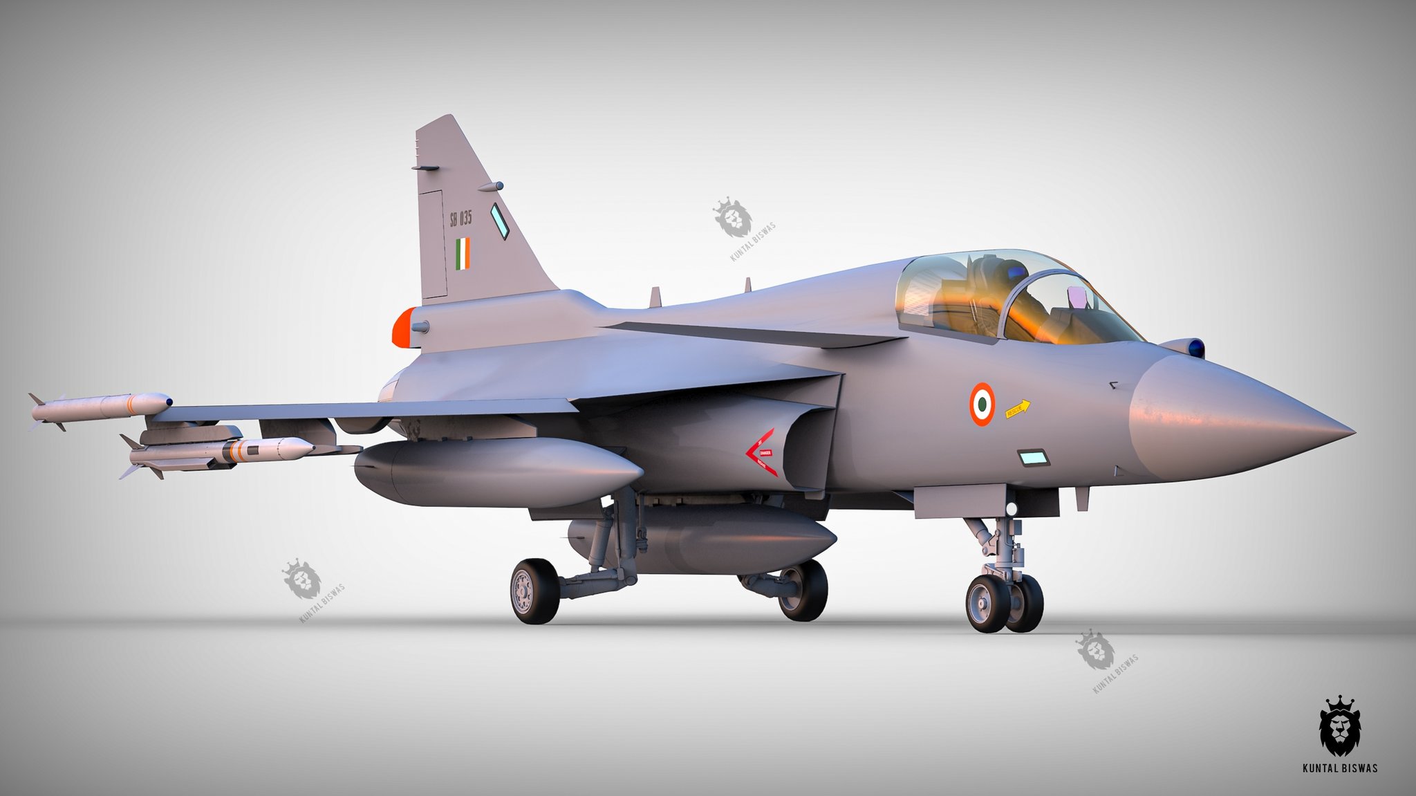

Posts: 23270
https://twitter.com/RAFIndia_/status/14 ... 53122?s=20 ---->
Incorporating all the technology developed and experience gained, a more powerful and bigger version Tejas Mk2 is under development.
• Tejas Mk2 roll-out is planned later this year
• First flight by 2024 and production by ~2027
• Six squadrons of Tejas Mk2 are planned
PIC - Kuntal Biswas
