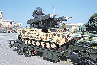

Looks like this photo was taken at the handover ceremony of a IAF Akash squadron.

Love that image SRai of Akash, what a find !!
