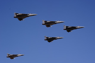

[quote="Indranil"]Why the hell doesn't Tejas adopt this low visibility pain scheme. Looks so much better.
WoW
WoW
Flying behind in close proximity like this would not have been possible without wake penetration trials.
Previously Tejas flew ahead
Or it flew alongside http://www.bharat-rakshak.com/IAF/Galle ... 2.jpg.html
But never behind before IOC-2

^^ Sir, in my post, I myself posted photos of Tejas flying ahead or side by side with other TD & MiG-21 with lateral separation.
My point was Tejas didnt fly behind any aircraft in turbulent airflow before 2013
I would be gladly corrected if you could show photos/videos showing Tejas flying behind another aircraft before 2013.
Sorry sir. I too would be overjoyed if you could show me one image of any plane flying directly behind another. It does not happen because the plane behind will not only be buffeted by turbulence it will also be ingesting hot exhaust gasestsarkar wrote:^^ Sir, in my post, I myself posted photos of Tejas flying ahead or side by side with other TD & MiG-21 with lateral separation.
Behind is always behind and below or behind and to one side. Not even behind and above. No matter whether an aircraft is certified or not they still must take precautions not to get in another plane's wake. Despite that the best of planes can have accidents
Dunno about all this behind business, but its trainers, transport and fighter order to me. I am glad they are flying everything they are making!tsarkar wrote:Flying behind in close proximity like this would not have been possible without wake penetration trials.
flying in the wake of a same size aircraft is NOT the same as flying in the wake of a different size aircraft... when flying small aircraft you are required to keep atleast a minutes separation between take offs, and four minutes if the preceding aircraft was a large one
the wake is essentially two large vortices that spin off the wingtips. in a large aircraft like a C17 or B747 these vortices will be massive and powerful... in effect its a function of the lift being generated to match the weight of the aircraft. a little plane flying into this cyclical airflow will suffer a number of severe forces - depending on which part of the vortex it is cutting through and how strong it still is
its not a simple matter
You're right, no one flies directly behind, but close behind like this -shiv wrote:Sorry sir. I too would be overjoyed if you could show me one image of any plane flying directly behind another. It does not happen because the plane behind will not only be buffeted by turbulence it will also be ingesting hot exhaust gasestsarkar wrote:^^ Sir, in my post, I myself posted photos of Tejas flying ahead or side by side with other TD & MiG-21 with lateral separation.
