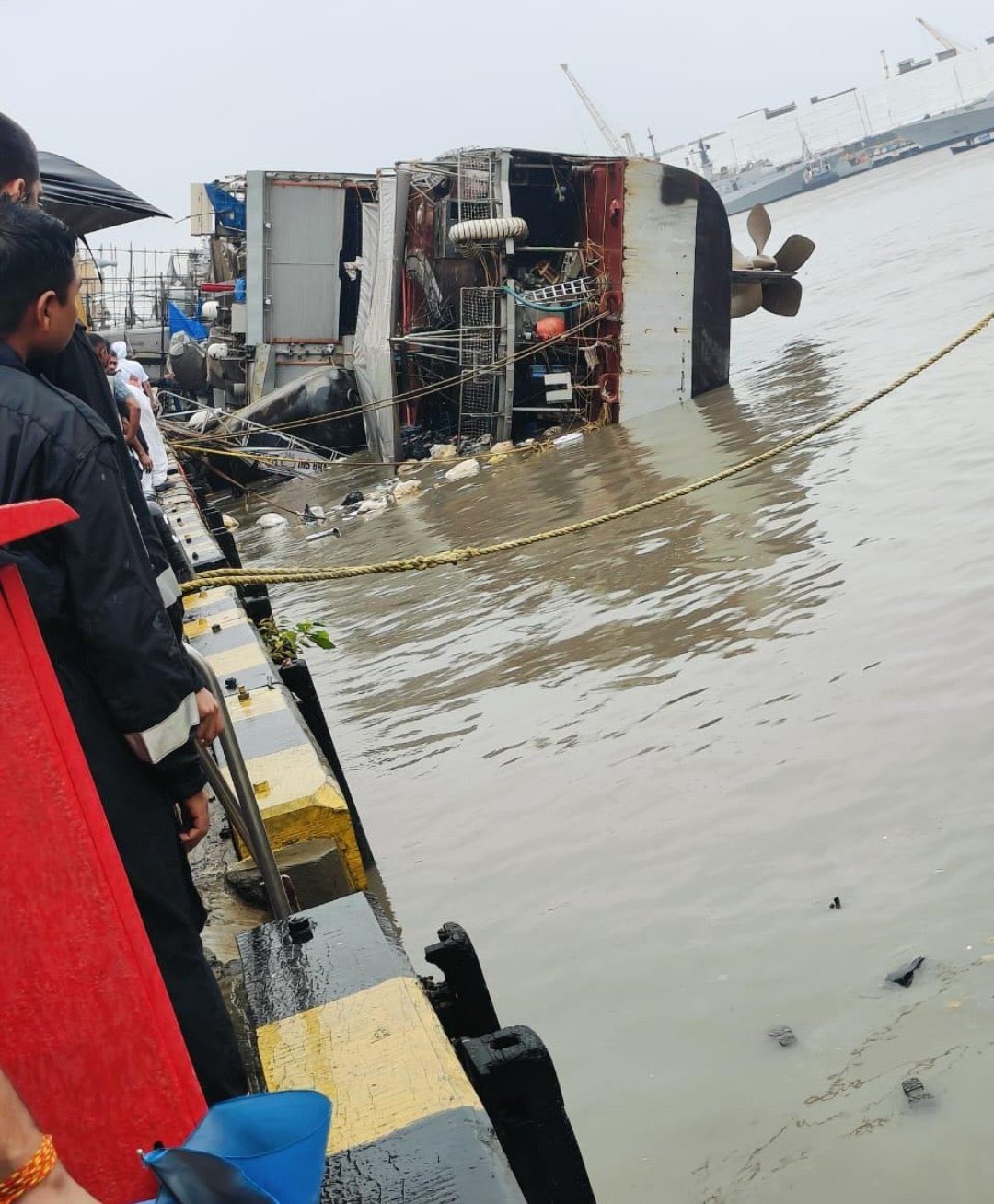

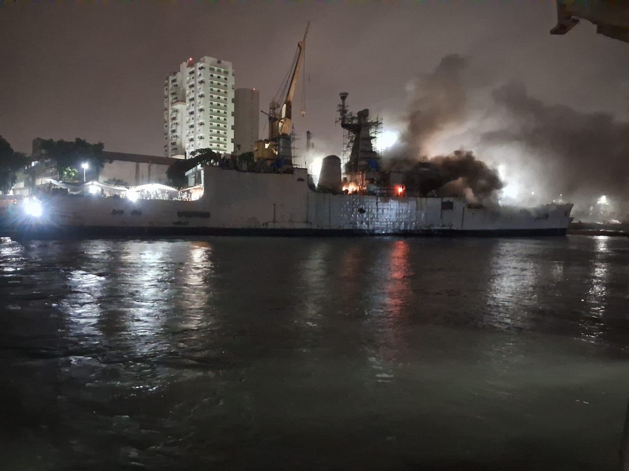

Betwa redux.
This is total loss. Shipyard ship losses are an unfortunate reality for nearly all Navies. But this is getting ridiculous.
IIRC, this is the 4th loss in Mumbai. In the last 10 years.
This ship is not coming back in service.
A big loss
Could have been worse if it had been at sea with its full complement
Hoping for good news on the missing sailor
It has been in sea for 10 years with no loss. This one is squarely bad conduct by the shipyard. Either the infra is poor (with lots of jugaad), or leadership, or unrealistic productivity or something shady, maybe chalta hai attitude. I hope court of enquiry is exhaustive and brings some real, practical recommendation.
It may get salvaged.
The earlier instructions were not strict enough?

From Commander Ashok Bijalwan (retd), Indian Navy.

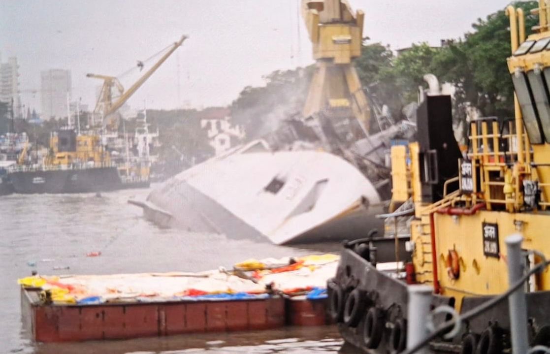

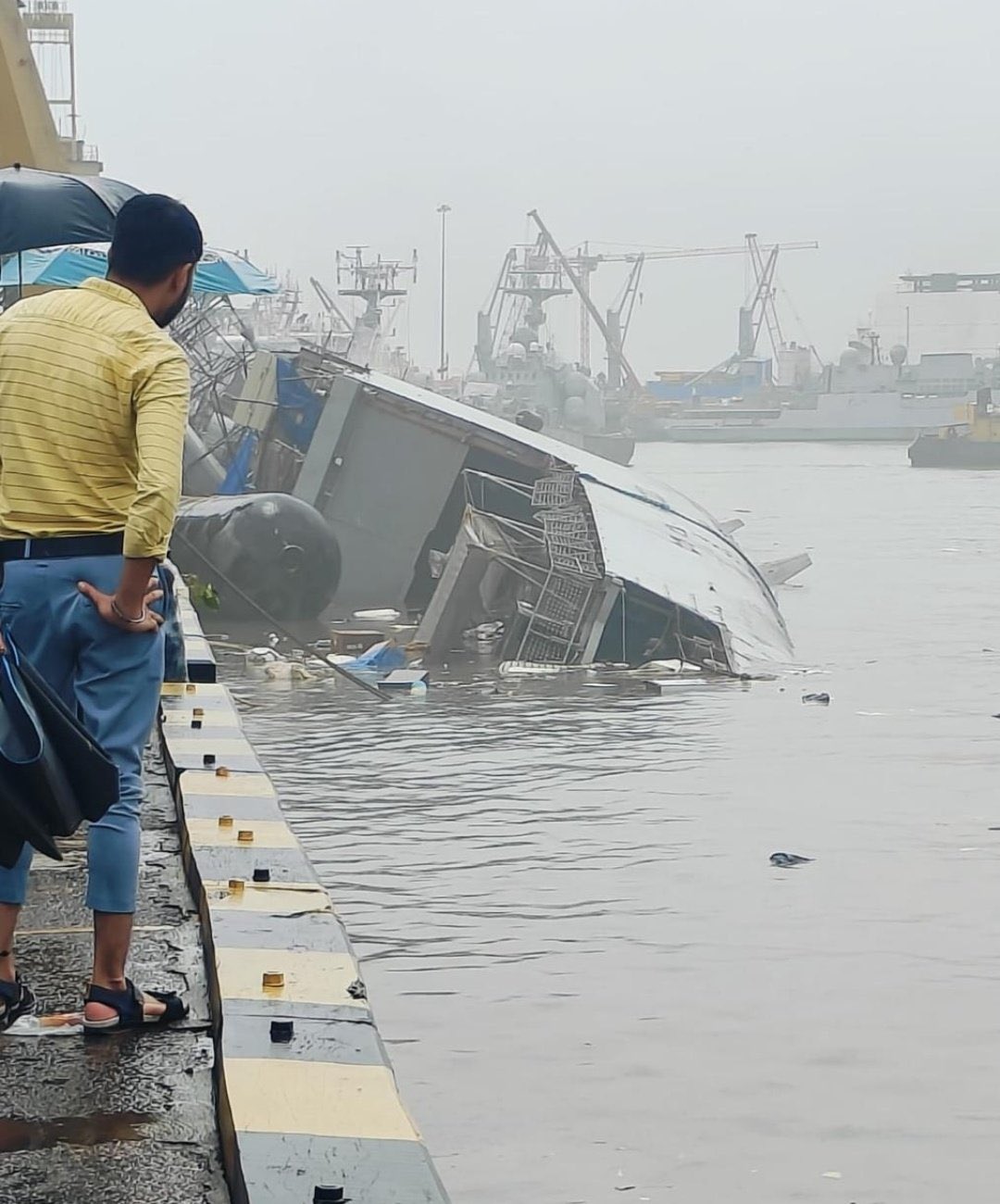

https://x.com/AshTheWiz/status/1815460146145095931 ---> WHAT COULD HAVE GONE WRONG IN THE CASE OF INS BRAHMAPUTRA?
(A FIRE FIGHTING AND DAMAGE CONTROL SPECIALIST’S PERSPECTIVE)
Disclaimer: This is a brief analysis based on the currently available information. The exact cause of the accident will be determined after detailed investigations by the appointed BoI (Board of Inquiry).
The Indian Navy has ordered a Board of Inquiry to investigate the cause of INS Brahmaputra capsizing in harbour. It will be an arduous effort and will take time to complete. In the meanwhile, let me apprise you Xweeple of what could have gone wrong from a Fire Fighting and Damage Control Specialist’s perspective.
A ship undergoing refit is at a greater risk against fire as many of its systems are under repair and refit. The situation is complicated by “Hot Work” (welding/ gas cutting) at multiple locations on board during this period. It is common for fires to take place on ships, especially during refit. However, when dealt with alacrity and with the right type of first-aid (portable) fire extinguisher, fires can be brought under control with ease. Problem arises when either of the two conditions is not met. Once the fire attains a bigger proportion, the next step is to fight it with water (or sea water to be specific as it is abundantly available all around). But when you spray water on the fire, a lot of it just drops on the deck and adds to the weight of the ship and affects its stability. To prevent it from doing so, the extra water must be pumped out and thrown overboard to maintain the ship’s stability.
In case the pumping out capacity of the ship is less than the amount of water being poured into the ship (whether by design or due to systems under refit), its stability is bound to be affected and depending upon which side the larger part of water is getting drained to, the ship will begin to develop a list/heel. When the ship is upright, the centre of gravity and centre of buoyancy are on the centreline (with CoG below the CoB) and oppose each other. As more water gets accumulated, the top weight increases causing the CoG to move upwards while the increase in list moves the CoB outwards and lower creating a righting arm which accentuates the list. Once the CoG crosses the level of CoB and moves above it, the ship can not maintain its buoyancy any longer and capsizes or topples over.
That is what seems to have taken place in the present case. As you can see in the accompanying video, the fire is blazing in the superstructure which means the water was adding to the top weight. In the second frame, the picture shows the ship having developed a dangerous list to port. This is the second incident of a Brahmaputra Class Frigate toppling over in harbour. In an earlier incident, INS Betwa suffered the same fate during its undocking in Mumbai in December 2016. This would raise doubts in the minds of the people about the design stability of the class of ship. I must assert that in warship design, the stability is sacrificed (to a certain extent) to improve the agility of the platform. I’m sure that the BoI will look into this aspect as well and make the required recommendation to take the corrective measures, if needed.
For those who think this is the end of INS Brahmaputra, hold on to your horses. Like INS Betwa, she will be up and back to ‘fighting fit’ in a few months' time. My best wishes to the Indian Navy and the entire team of INS Brahmaputra. Lastly, my prayers for the well being of the junior sailor who has been reported missing in the incident.
