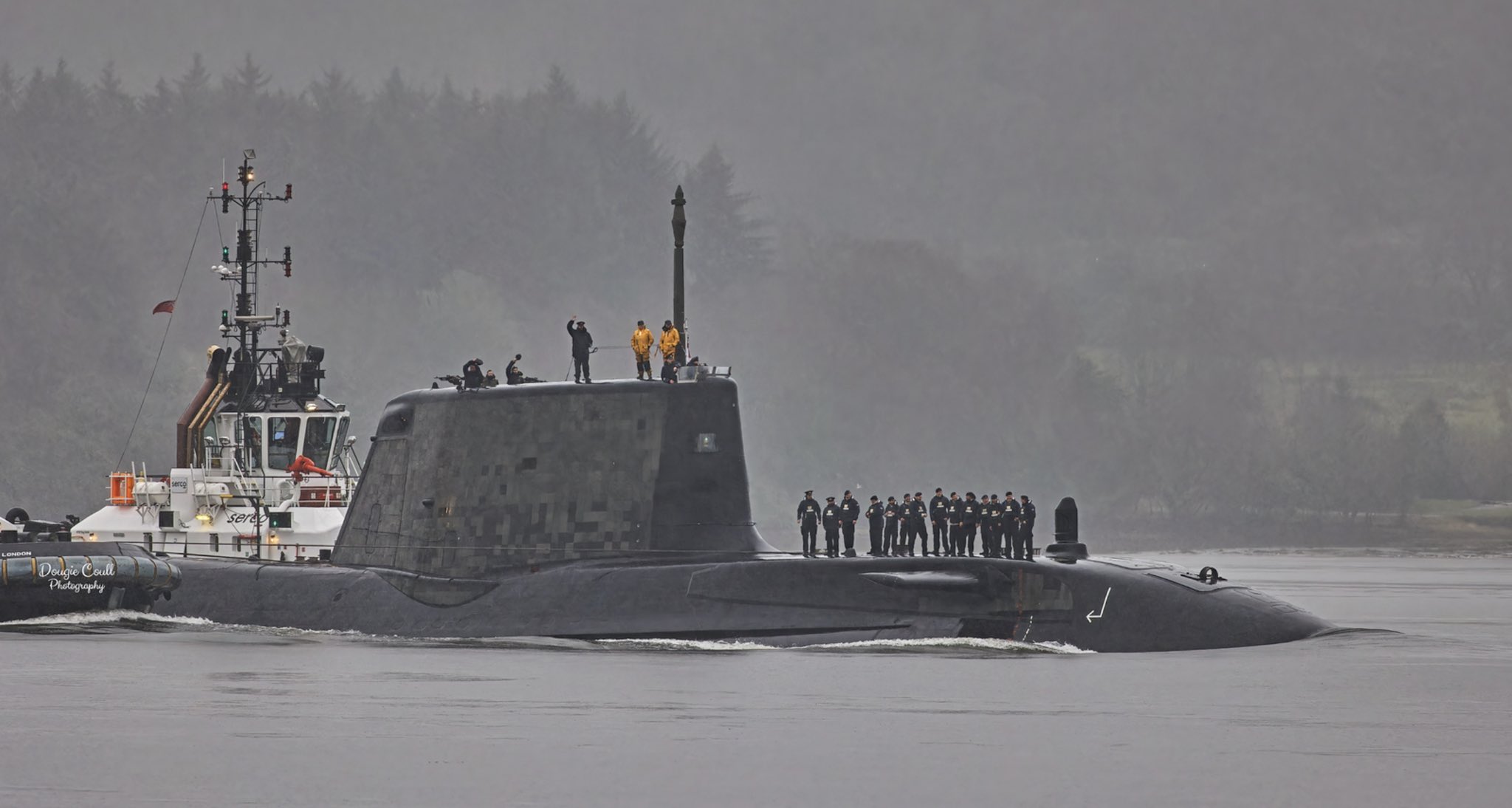

An Astute Class boat of the Royal Navy, recently completed a 403 day patrol and returned home to the UK. That is more than a year long patrol! Additional pictures are there in the link below. At 403 days, this is an intelligence gathering mission.
So just a caveat ---> The boat is limited in endurance in terms of food & other supplies, but unlimited in terms of energy (nuclear reactor). The PWR 2 HEU reactor on board, has a life expectancy of 30 years! So the boat, will reload on such supplies from a friendly theatre and then head back to her mission theatre. And if the mission requires a 24-7 vigilance, rest assured that there are other Astute Class boats + other Allied boats in the same theatre for redundancies. Once the Aussie n-boats become operational, the number of boats available will only increase. This is the beauty of a SSN. You cannot do a continuous 403 day patrol, with a SSK. As of today, there are four Astute Class boats in active service + 1 in sea trials and two more under construction.
For India, a six-build SSN program is the bare minimum and we are reportedly even cutting that number to half.
https://twitter.com/DougieCoullPics/sta ... 07809?s=20 ---> Royal Navy Astute class boat returning after 403 day patrol, families are there to greet their loved ones on arrival.

Rakesh wrote:An Astute Class boat of the Royal Navy, recently completed a 403 day patrol and returned home to the UK. That is more than a year long...
400 plus days in a tight enclosed space. 95 % or more time submerged. Feels more like being buried in a tomb than say put in a jail. Gives me the shivers just thinking about it.

90 days or so. After that, they need to surface to get some food.

However, I think they also change crews along with getting food.
The boats need maintenance too.

Was it with a single crew. Or with gold and blue crews.
A crew rotation system means that the sub just docks in the fwd operations base. The relief crew is already waiting. Both crews conduct any minor repairs, if required. Resupply the boat and the second crew sails out. The first crew goes home.
This way, a 400 day deployment will have the sub out at sea for over 360 days.
