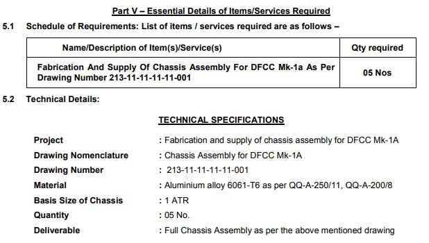

ADE has issued a tender for Tejas MKIA DFCC Chassis Assembly. The tender opens by end august and first unit to be supplied in 3 months from date of contract
The fabrication of the chassis has to be carried out in Three Stages, based on the following Terms &
Conditions:
1) FIRST UNIT - PROTOTYPE UNIT (01 No.)
• The first prototype unit shall be fabricated using the first set of chassis component drawings released
and approved by ADE.
• The first prototype unit shall be delivered within 03 months from the date of placement of
order/contract.
• Depending on the outcome of the fabricated components and results of the preliminary assembly
tests and checks, the second set of drawings will be released with modifications (if required).
2) SECOND UNIT - QUALIFICATION TEST (QT) UNIT (01 No.)
• The second unit, which will be the Qualification Test (QT) unit, shall be fabricated from the modified
set of drawings approved and released by ADE.
• The QT unit shall be delivered within 03 months from the date of receipt of the modified drawings. T0
for the QT unit starts from the date of receipt of the modified drawings from ADE.
• Based on the Qualification Tests of the QT unit carried out in ADE in collaboration BEL Bangalore,
the third set of components drawings will be released (if required).
3) THIRD, FOURTH & FIFTH UNITS - FLIGHT WORTHY UNITS (03 Nos.)
• 03 numbers of Flight Worthy units shall be fabricated from the final modified set of drawings
approved and released by ADE. T0 for these three units starts from the date of receipt of the
• These units shall be delivered together within 04 months from the date of receipt of the final modified
drawings.
• These final flights worthy units will accepted based on the mechanical inspection reports and
Qualification Tests results carried out in ADE in collaboration BEL Bangalore.
ADE has the right to short-close the demand, in case the design requirement of fins with 0.4mm or lesser
thickness (as mentioned in Annexure 'A') is not achieved even after the Second Unit (QT Unit) is fabricated.
4) Detailed drawings shall be obtained from ADE against Non Disclosure Agreement for details refer
1.1, Part 1(A) of RFP at Page No. 3.

https://twitter.com/strategic_front/sta ... 41184?s=21 —> DRDO lab ADE has issued tender for fabrication of parts for LCA Mk1A. Delivery period is 14 Months from the effective date of contract.

^^That is the Digital Flight Control Computer chassis mechanicals. IIRC, DataPatterns made the previous version.
Actually, order had been placed with some of the participant organizations for MK1A equipment some time ago, and they are now warming up now.
Dileep, Looks like a machined part from the Aluminum Alloy 6061-T6.
So a set of six plates with grooves for printer boards and recess for connectors?
Yup. The cake is baked. This is just due process. They have floated this tender for the second time. I think the first time was a couple of months back. I think the cake was baked even then.Dileep wrote:^^That is the Digital Flight Control Computer chassis mechanicals. IIRC, DataPatterns made the previous version.

Here is the image of current DFCC. They have moved to PowerPC platform I heard.ramana wrote:Dileep, Looks like a machined part from the Aluminum Alloy 6061-T6.
