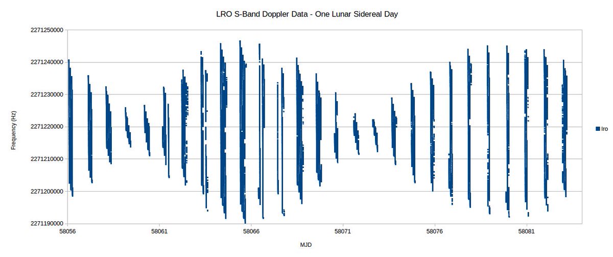

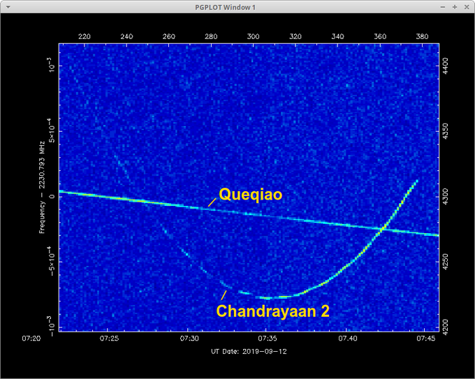

<This is the guy whose github code we ran into..>Amateurs used an old 25-meter radio telescope owned by the Netherlands Institute for Radio Astronomy to track Vikram’s descent. The frequency of the lander’s radio transmissions shifted based on its speed relative to Earth. That phenomenon, known as the Doppler effect, is similar to the changing pitch of train whistles and police sirens as they speed by.
Cees Bassa, an astronomer at the Dutch institute who participated in the effort, calculated the lander’s velocity, which matched predictions during the first phase of the firing of the engines.
He could not say what caused the oscillations, but he now believes that the end of the radio transmissions coincided with Vikram hitting the ground. It was supposed to touch down at less than five miles per hour.
The Doppler data indicate that Vikram was instead moving at more than 110 miles per hour.

Meanwhile, as expected LRO was pretty active recently. It was in contact with DSN and non-DSN ground stations. The signal was visible even when DSN Now wasn't showing a contact. Of course, my guess is it will take some time to do image analysis and may e some time before before we will see a result regarding Vikram lander.
Two more days till sun sets near Vikram .. LRO will again have a near pass with this site in a month or so.

Someone mentioned Queqiao ..
Small tidbit .. Quequiao's and CY2's path sort of crossed on 9/12.. we could (or perhaps did) use Chinese relay sat at L2 tooAmber G. wrote:The Relay sat is Queqiao. It is in a "halo" orbit near the Earth-Moon L2 point.Dasari wrote:
Geometrically it is not possible to cover with less than three, unless they relay it with three other Geo Sync satellites of the earth.
For details, do a search on "halo" orbit, or "Lagrangian" points of Earth-Moon system.
(Basically A relay sat in such a halo orbit would be in continuous view of both the Earth and the far side of the Moon (most of the far side) so it can be used as a relay station. Actually NASA was thinking of such a sat in 1960-70's but they thought they will not need it as they restricted themselves to the near side of the moon)
