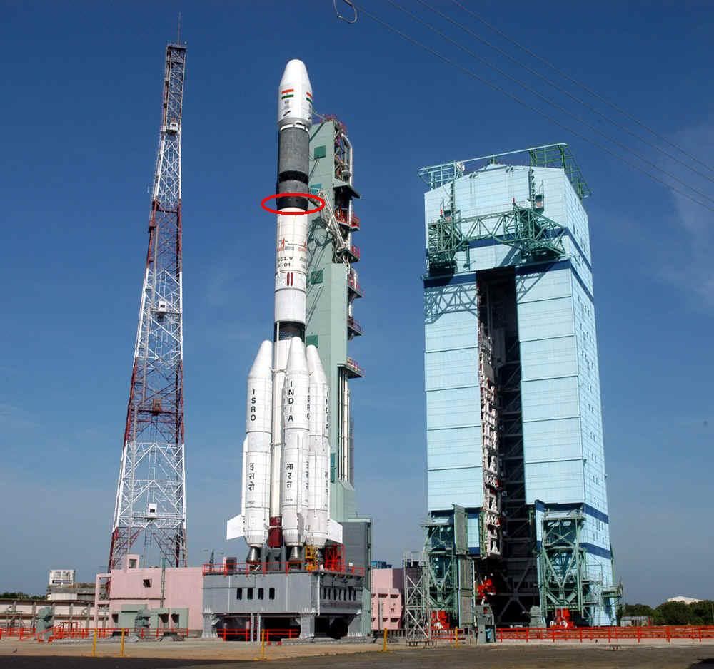

AJames wrote:
Gagan wrote:CUS & Shroud
I am not an aerodynamicist, but looking at the image, surely the cylindrical lip at the bottom will catch the supersonic air flowing over it and cause severe air turbulence inside. Shouldn't the lattice be right at the bottom of any shroud provided?
It is always covered with a composite cylindrical covering for that exact reason. This is the shroud that got deformed. I have illustrated this in the following pictures.

KrishG wrote:
AJames wrote:CUS & Shroud
The point I was making is that from what I understand, the open lattice allows the upper stage engines to be started before the stages separate by allowing the rocket exhaust gases to be vented out via the open lattice section. This means that the top of the section below the upper stage must have a cone shaped end and an open lattice connecting to the bottom circumference of the cone. The diagram shows two cylindrical shrouds with an open lattice between them, above the level of the bottom of the exhaust nozzle. I this was the case, and there was no second lattice below, isn't the lower cylindrical shroud going to act as an air scoop, causing turbulence within the shroud?
From the photos, it looks like what may be two open lattices - the additional one below the lower cylindrical shroud which is shown on the sketch. This may make sense to vent air through which would be fine. If it is a band of black painted shroud below what is shown on the sketch however, then you have an air scoop.
There is also what looks like flames coming out of of this area at launch. Is this some kind of directional control retro rocket?
By the way even if GG is adopted for the GSLV upper stage, I hope India doesn't give up on the SC cryo engine. It would make a great engine for a first stage cryo, and the Space Shuttle demonstrates that it is reliable if started on the ground and can be shut down if ignition fails, before the solid fuel boosters are lit, since none of the Shuttle launches failed as a result of the cryo engines themselves. From my understanding, most SC cryo failures have been due to problems with starting up.

That diagram of the CUS and the shroud is something that I quickly made on my computer. It was meant to be a rough estimate of what to me appears to be the engine and its covering shroud.
It is not an official ISRO diagram, and I am sure has factual errors in it.
___________________________________________________________________________________________
I was wondering about the venting there, and the possible aerodynamic implications of the same.
But as you've pointed out, it allows that engine to be started before stage seperation occurs. Though in the GSLV launches so far, that has not been what ISRO has been doing, CUS ignition and Stage separation happen close together, hardly a second or two.
The US space shuttle ignites its cryo engines on the ground, and that design allows for such an arrangement, and the cryo also contributes to the launch thrust there. But I wonder how this works out in a staged rocket with stages stacked one over the other. How do you start a cryo stage that is say the 3rd stage, on the ground, and then it takes over after the 2nd stage has been jettisoned.
