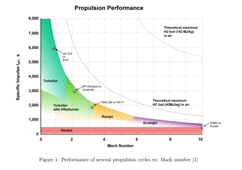

In the schematics of Meteor, I noticed the placements of the 2 air intakes. They didn't seem symmetrical, at least from the angle in the pictures. I am assuming those are designed to maximize the maneuvering envelope.
Does SFDR utilize any of Akash's technologies like air-intake design?
Also, if Ramjet is ideal for long range engagements, is Akash's short range the result of it being a SAM & a liquid fuelled one at that (causing weight increase)?

1. What do you mean by the intakes are not symmetrical on Meteor? They are perfect mirror images of each other, but not placed at 180 degrees.
2. SFDR does not lean on Akash. DRDL is studing an LFRJ design. That does use Akash's geomerty.
3. Akash is not liquid fueled. Its short range is because of two reasons: Mk1 is guided by land-based radar and 2, it doesn't have a coast phase. It is just powered all the way through. Akash 1S addressed problem 1. Akash mk2 tkaes care of both of the above. I expect it to way around 350 kgs and have a range of 50 kms.

Prem ji,
