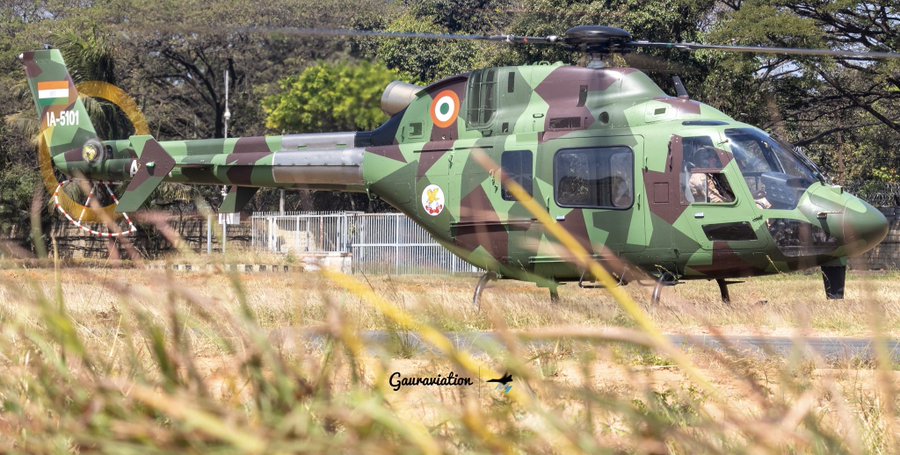

https://x.com/Rethik_D/status/1794325441089839182 ---> Looks like IAF LUH.
https://x.com/Rethik_D/status/1794331431633850793 ---> Production plant looks new, Tumakuru or old one.
