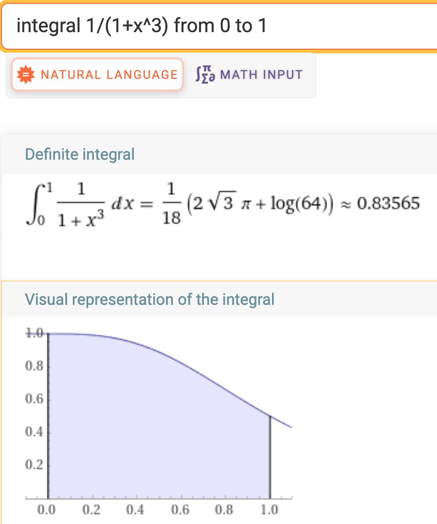

The above problem, I chose 1/(1+x^3) instead of routine x^2.. The integral is little harder but it is still beautiful. ..
(Thanks for https://byjus.com/infinite-series-calculator/ link.. in return, the integral can also be done here :) ... The result matches your value.
Posts: 14784
Re: BR Maths Corner-1
that visual representation is irrelevant, no?!

Posts: 12582
Vayutuvan wrote:that visual representation is irrelevant, no?!
No. Visual representation and connection between area of a curve and integrals is important aspect - Historically Integral calculus was developed before differential calculus. Anyway the cut-and-paste came directly from mathematical app :).

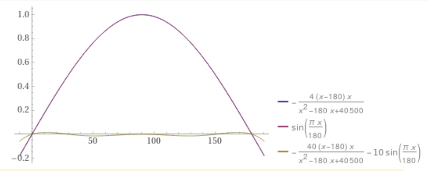

^^^ Just to show just one sample - 1,400 years ago, Mahabhaskariya of Bhaskara wrote this approximation for the sine function (0 ≤ x ≤ π). He actually credits this to his ancient books -- so the formula may have been discovered about 500 years before he wrote about it.
The formula - written in modern math language - (I am writing it, translation from original written in modern math notation using degrees)
sin(x) = 4(180-x)x/(40500 - (180-x)x)
Just try to see how accurate this is -
Here is the graph from 0 to 180 degrees - Its absolutely accurate for 0, 30, 90, 150, 180 degrees and for the rest the difference is *very* small - I have drawn the error magnified 10 times! - still it is negligible.
