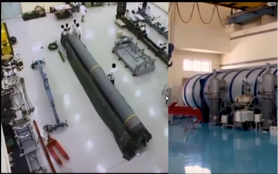

Anup Sayare
@sayareakd
looks like SLBM k15 and one on right looks like K4.
https://twitter.com/sayareakd/status/12 ... 6461480960
