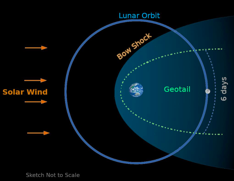

^^^ For more detailsStudying Earth’s extended magnetosphere (geotail)plasma around Moon
ISRO reports that the intensity of these particles changed as much as ten times the levels outside the geotail, indicating the complex interaction of these particles with the magnetic field.
(This geotail crosses the Moon’s orbit and extends beyond it during its rotation around Earth. The Moon passes through this geotail region for almost six days around the full moon day. Therefore, during the full Moon in September, CLASS was able to detect the charged particles and their intensity variation.)
(Note:) Earth’s magnetic field obstructs the solar wind plasma resulting in a magnetic envelope around Earth, called the magnetosphere. While this magnetosphere is compressed to around 22,000 km on the side facing the sun, it stretches into a long tail on the opposite side, known as the geotail.
CLASS is designed to measure direct signatures of elements such as Sodium, Calcium, Aluminium, Silicon, Titanium and Iron, on the lunar surface using the secondary x-ray radiations from the Moon.

- CLASS can provide some valuable data about the environment around Earth.. For about six days each month, the moon passes within Earth's geotail, -- distorted bubble of Earth's magnetosphere created by the constant push of the solar wind that spews out from the sun..
- ISRO released some initial data from CLASS (The device is designed to measure X-ray fluorescence, one can identify where on the lunar surface certain elements — like magnesium, aluminum, silicon and iron — are located. The instrument works best when the sun releases a solar flare - but even when there is no flare at the lunar surface but
when CY2 is inside Earth's geotail, the instrument can analyze how that environment differs from beyond the geotail. So this is a bonus, studying Earth's magnetosphere.
- CLASS did just that, measuring a sharp increase in particles that ISRO has identified as electrons.. Initial data but I think it is exciting as we get more data about their spectrum etc. Considering that CY2 is going to spend a lot of time this may be important data for us.

- CY2 has two top notch x-ray related equipments. CLASS ( CY2 Large Area Soft X-ray Spectrometer) and XSM ( Solar X-ray Monitor).
- They, among other things, study solar flares (strong source of X-rays).
- These x-rays, are like "flash bulbs" which "illuminates" moon surface. This prompts the elements to absorb these X-rays and emit a unique spectrum of light based on which element it is. These "secondary X-ray emissions" can be read by Chandrayaan 2's CLASS instrument. This can identify minerals on the moon's surface. And can make a detailed mineralogical map of the moon. (This can identify even elements like iron -- and with luck Vikram's elements)
- Moon, does not have a magnetic core (like spinning earth) and no atmosphere, hence solar wind reaches the surface without being weakened - on earth we are safe from that solar wind.
*** Apart from studying moon, these instruments also are useful is studying solar wind -- as we do on earth based sats..
(And this is what was my previous post was about)
- Similar instruments on earth's orbit, study earth's magnetic sphere by effects of solar wind. Since satellite communications, GPS accuracies etc depend on effects of solar flares, we need good data for this.
- CY2 is not in earth's orbit and normally outside geotail but about 6 days it is in the shadow, so these experiments and data are useful. (This is what I was mentioning before.. more data taken over years will be very good)
- CLASS was able to do this study and results are good.
