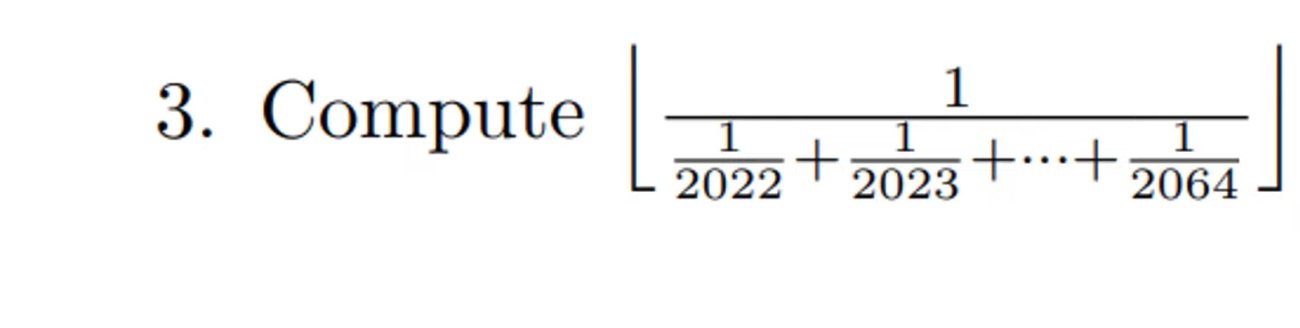

Just for fun on Saturday: Three easy problems for everyone from Stanford Math Tournament:
And a fun looking challenge (Actually this is from a national math olympiad - but not hard if you find the main reasoning).
- No calculators are needed for this one.
BRF: 202212-01
BRF: 202212-02
(Not hard but could be tricky - so be careful
BRF: 202212-03
Here one has to find only the integer part of the expression. Again, no calculators. (If answer is 47.234.... etc, you need to find 47 only)

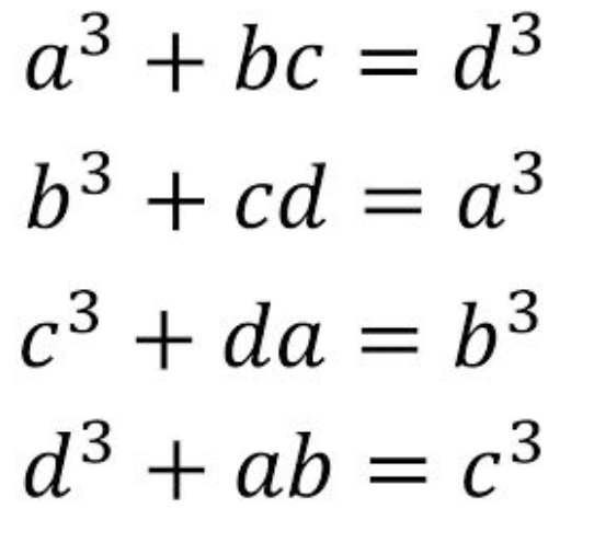

BRF 202212 -04 (***)

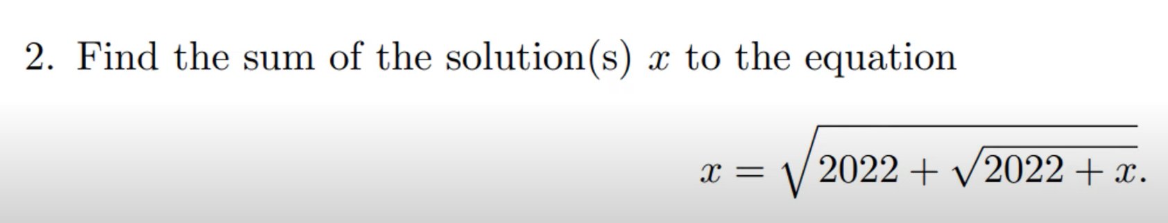

Finally the math olympiad question... very simple looking!
Give a, b , c, d are real numbers, solve:
BRF: 202212-01
BRF: 202212-02
BRF: 202212-03
Re: BR Maths Corner-1
Wow! Excellent solutions!sudarshan wrote:
(All are correct !)
Only one comment:
For BRF: 202212-02 I said "
(Not hard but could be tricky - so be careful :) ) .. so the clear looking answer is tricky.
Yes, as you said there are four solutions to
(x^-2022)^2 -x - 2022 =0
(And some does come out to be zero - all real solutions) BUT the equation given has: *ONLY* one solution,
namely x =(1 + √8089)/2 (The correct answer, and it is not zero)
Because: f(x) = √a by definition has only one solution 9positive only). for example x^2=4 has two solutions but √4 is *only* +2.
Note:
x≈-45.458 solution is not valid ... (Note that x, if real, has to be positive by definition)
x≈44.458 solution not valid check it out, when you substitute in x≈44.458 you get √(2022 +√(2022 + 44.458)) is NOT 44.458
x≈-44.469 Not valid.
x≈45.469 is the only valid solution.
In any case excellent solution and wonderful write up.
^^ Thanks!
With the first problem - I used to have a very hard time working with "a^2 + ab + b^2" or "a^2 - ab + b^2" situations. It's not quite (a+b)^2, nor (a-b)^2. Then I realized that it works much better if you go with the cubes: a^3 - b^3 or: a^3 + b^3.
The second problem took the longest, and I thought the trick was that you have to be aware that there are negative solutions. I guess it's a convention in math that the sqrt sign implies only the positive square root? All four roots were also very easy to identify using Excel, so I could verify that the sum was zero, but I'm not sure how to actually solve a quartic equation analytically.
The third problem was a standard bounds estimation, which occurs rather frequently in engg. scenarios.
The fourth one - I just fortuitously noticed that the cube terms could be canceled out, if one considered all the equations as an aggregate.
I've used LaTeX, but the material above was actually generated using MS Word equation editor. You can see the red underlines, where Word over-enthusiastically corrects the "typos" in the text. Then I just did a screen grab and posted the resulting image. Otherwise, it's a mega pain, trying to put all that math stuff in a text message.

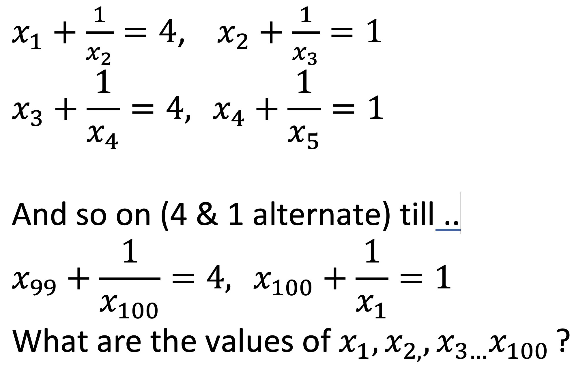

Okay one more for this Sunday...
(Question is from a well known contest - It is not hard (if one hits upon the right idea, kind of simple) and kind of cute)
One can assume all x's are real numbers.
sire my shAshTaanga pranaamsudarshan wrote:[img]...https://live.staticflickr.com/65535/525 ... 4e41_o.png[/img]
^ Mine too, in response
The problem is non-linear because of the 1/x2, 1/x3... terms, but if it were linear, then it would lead to a "sparse matrix," which is much easier to solve (diagonalize) than a regular matrix. But even in the non-linear case, the same principle applies - eliminate one variable at a time (having only two variables at a time in any equation makes this pretty easy). So after eliminating x2, x3, x4,... etc. in succession, with the final equation, it ends up relating the first variable to itself, which is pretty easy to deal with.
Sudashanji - Excellent. Aryabhatta (also Brahmgupta) would be proud.
(The problem, this or similar, IIRC appeared once in Putnam Competition !)
(Continued fractions is one of my favorite techniques which is not that much taught in formal courses, but I like to teach ..).
The technique - if x = f(f(x) or (x = f(f(f....(f(x) for that matter then f(x) = x is a solution. Quite intuitive but deep. Sometimes, it is the only solution.
The same theme was in my Q BRF: 202212-02.
One can reduce the equation x = √(2022+√(2022+x)) by the same logic to x = √(2022+x) resulting to simple x = (1+√(4*2022+1))/2
..(Taking *only* one of the (positive) root of the resulting quadrating equation).
(may be in some next year SMT IMO or JEE one would see the problem like x = √(2023+√(2023+(√2023+x)))..
(This will return in 6 degree equation but still only one valid solution)

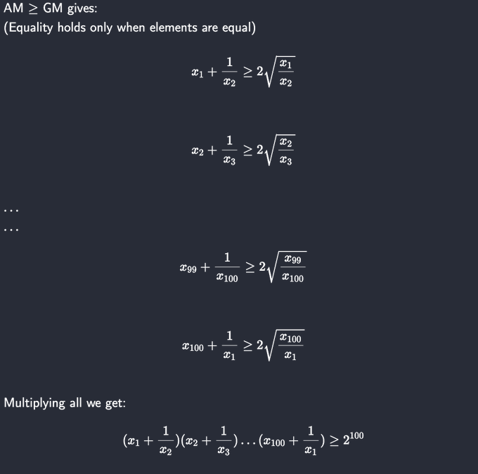

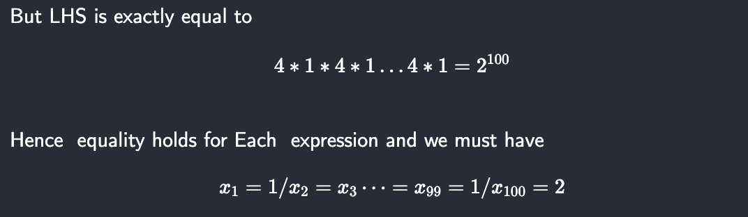

Okay... here is one solution to problem posted above
Along with Sudarshan's solution above, let me post it here... (Since BRF does not have LaTeX interface, I too am posting screenshots
QED!
QED!
Amber ji, this is a great solution, but doesn't it assume that x1/x2, x2/x3, etc. are all positive? Otherwise the sqrt in the geometric mean will not yield real numbers. It's true that the sqrt terms all cancel out, but are complex GMs defined? If so, is there a good definition of >= for complex numbers?Amber G. wrote:Okay... here is one solution to problem posted above
Along with Sudarshan's solution above, let me post it here... (Since BRF does not have LaTeX interface, I too am posting screenshots:
[img]...[/img]
QED!
^^^^ Very good point..(When I gave this problem to some students, I made it a little easier and explicitly said x1,x2.. all are positive real numbers.. In BRF I was careful to point it out that assume all *are* *real*)
--- But a moments thought, one can 'enhance' the proof to include *all* real numbers. For complex numbers, a little more work is needed.
(but can be done). (For complex numbers, one can use the polar form (r*e^(i theta) with r as real and >0)
The trick is to introduce |x_1| which is always positive and then √(|x1|/|x2|) can be well defined. and AM-GM can be used. One then introduce that |x| >= x (does not matter x is positive or not. Yes it requires some more work (and needs to be shown if problem solution is to be graded

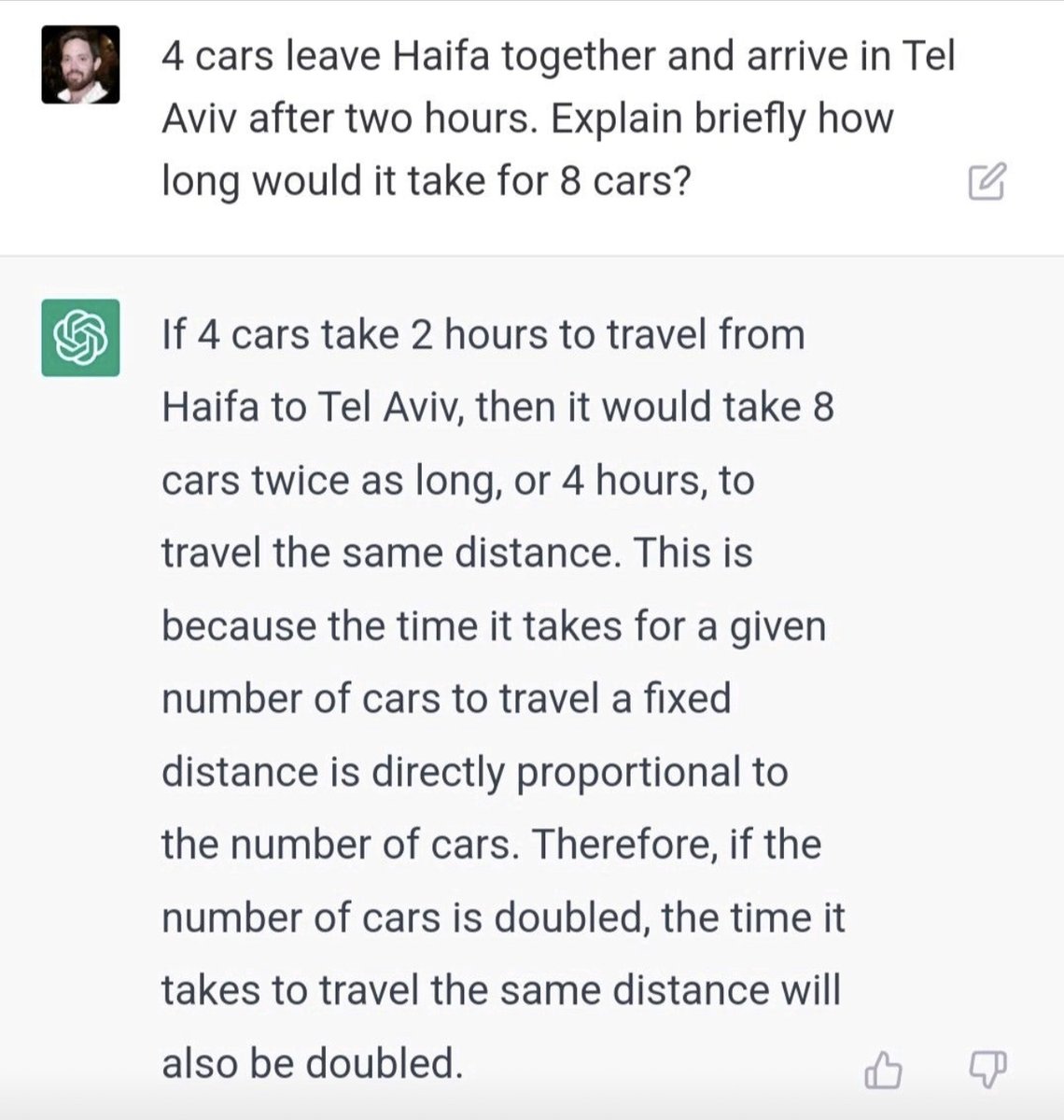

Thanks. I looked up ChatGPT and got some very interesting feedback from friends...We have come a long way from early AI of my era (Eliza of 1970's, 80's)...Prem Kumar wrote:Amber G: I plugged your question into ChatGPT, the latest release by OpenAI, that's got everyone super-excited. This is what it wrote back. You can see that it kind of gets into a "a = a" type of situation. But then eventually figures out at least 1 correct answer
Wrt ChatGPT, IMO, - Large language models like this can spout nonsense in a confident, authoritative tone. This overconfidence - which reflects the data they’re trained on - makes them more likely to mislead.
While real experts know when to sound confident, and when to let others know they’re at the boundaries of their knowledge. Experts know, and can describe, the boundaries of what they know.
Key is to build a large language models that can accurately decide when to be confident and when not to will reduce their risk of misinformation and build trust.
--- Pretty obvious, the output 'solution' put by chatGPT reeks of impressive 'math language' - even one correct solution(which most people will get in 15 seconds anyway) - but quite non-sense mumbo-jumbo and full of math-errors, as described.

Interesting q & a with ChatGPT. While the response from ChatGPT is a howler, some things to consider, as below (just out of academic interest
1. Many people also reason this way, and have to learn by experience that such reasoning is incorrect (one can surmise that maybe, the AI picked up on this kind of faulty *human* reasoning, from trawling through the internet)
2. The AI is an evolving entity, and can also learn from "experience" (in this case - the experience comes from the programmers initially, beyond that - it's anybody's guess, how well the AI is going to evolve on its own)
3. The answer to the problem: that 8 cars will also take the same 2 hours as 4 cars - does this imply that the answer is always 2 hours, irrespective of the number of cars?
Not quite. The answer is only valid, so long as one is not constrained by the finiteness of the road itself.
For example - how about 8 million cars? Can they all fit on the road? If not, the number of cars which can fit, depends on the width and length of the road itself. Beyond that limit, and going to more and more cars (eventually - infinite cars) - the travel time indeed becomes linear with the number of cars! Because only so many cars can fit on the road, traveling at a finite speed, and one set of cars has to get off the road before the next set can even get on (assuming infinite parking lots on either side, with no delay in getting on and off).
So the solution to the problem starts off with a constant time, regardless of the number of cars, then goes through an intermediate stage, before hitting a linear asymptote.
