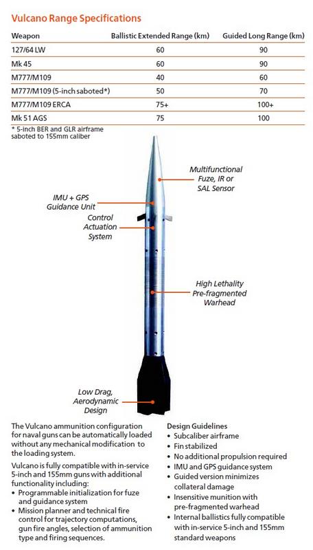

It seems the IN is interested in the LRAPs for offshore bombardment once defences are neutralised and mark 45s seems to be [only ?] option., also "stealthy" ? maybe brar can provide some more details

kit wrote:It seems the IN is interested in the LRAPs for offshore bombardment once defences are neutralised and mark 45s seems to be [only ?] option., also "stealthy" ? maybe brar can provide some more details
IMO You can neutralize the defenses and operate the vessel 50+ km away from the shore but when you are close to the shore there is too many platforms that can threaten a ship. You cannot neutralize portable anti ship missiles, even land artillery, anti tank missiles and now we have short range drones as well.

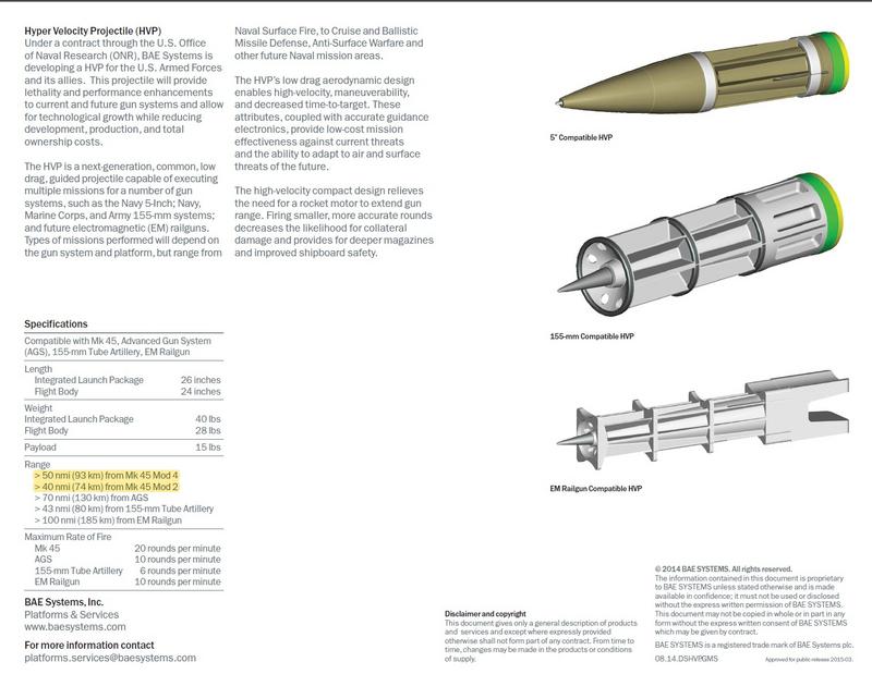

The US Navy fired 20 HVP's from MK-45's at RIMPAC-2018. Concurrently, it is also developing low and medium cost seekers for the HVP rounds for a complete end to end missile defeat system that is cost optimized for a set target (high performance active seeker for the higher end threats and command guided lower cost solutions for simpler threats). The package with the HVP is expected to weight around 50% of what a current 5-inch gun round weighs and subsequently triple its range when used in surface warfare applications while also opening up applications in the Cruise Missile Defense mission. For those types of applications, the 5-inch gun is more future proof though there are some interesting things also happening on smaller guns as well but no HVP like solution is aimed at them.
Additionally, land attack Precision guided projectiles, aimed at the MK45, already provide >80 km range from the gun. That too is not available on smaller guns. The US Navy put BAE-Leonardo's Vulcano on contract as well and that opens up very interesting options for that missions. These things are just getting started now but if you factor in the service life of a future combatant then it is quite possible that these would be more widespread by the time the ship becomes operational or during the course of its service. There are about a dozen MK45 operators and some 155 guns currently operational..that's a large installed based for solutions like the two mentioned to be developed and be made cost effective via EOS.

The 5-inch MK45 is a future proof option for both long range land attack, and for the Cruise Missile Defense roles. CMD is probably a more pressing need than Anti Aircraft given the potential number of targets etc so that is the focus of the HVP and other efforts. Both are promising areas that are rapidly being developed and explored. Both are looking at minimal to NO changes to the gun and its associated systems. And these things aren't just happening in the lab but demonstrations to that end are happening out at sea or at a weapons range. A 90km ranged projectile with a SAL or IIR seeker can have surface attack applications as well especially at a rate of fire of 20 rounds per minute. The MK45 is a good choice for a gun that is going to be in service for decades into the future as things like the Excalibur N5, Vulcano rounds and the Hyper-Velocity Projectile are already available or will be in the short term and will only get better via iteration. All these in addition to currently used rounds open up new missions as well extend the current missions to both longer distances ( 2x and 3x) with more accuracy (GPS, IIR and SAL guidance for the land attack projectiles and active or command guidance for HVP).
https://www.youtube.com/watch?v=TY6g-SfbMVM
Posts: 36100
Re: Indian Navy News & Discussion - 03 July 2018
brar_w wrote:The 5-inch MK45 is a future proof option for both long range land attack, and for the Cruise Missile Defense roles. CMD is probably a more pressing need than Anti Aircraft given the potential number of targets etc so that is the focus of the HVP and other efforts. Both are promising areas that are rapidly being developed and explored. Both are looking at minimal to NO changes to the gun and its associated systems. And these things aren't just happening in the lab but demonstrations to that end are happening out at sea or at a weapons range. A 90km ranged projectile with a SAL or IIR seeker can have surface attack applications as well especially at a rate of fire of 20 rounds per minute. The MK45 is a good choice for a gun that is going to be in service for decades into the future.
India has a big wish list.
The US will not offer systems that will become the cause of ugly controversies and generate bad publicity for both the seller and the customer.
If the US actually offers any system to India, rest assured that a lot of background work has already gone in and a tacit approval has already been obtained by the seller.
Public rejection of any offer neither serves the interest of the seller nor the buyer.
The MK45 FMS notification just went to the Congress so the GOTUS has approved it. The Vulcano is not a US controlled weapon but one developed by BAE systems and Leonardo with internal or non US funding. The Excalibur is already operational with the Indian Army. The Hyper-Velocity projectile designed for the 5 inch gun application is being designed with exportability in mind. My post was in reference to the future proof nature of the weapon as many munitions are being developed for its use by the US and elsewhere as well. These add to the existing missions or open up new missions. More will be developed in the future as the gun has a large installed base which incentivises investment from various OEM's around the world.

Vulcano is an Italian munition family from Leonardo. As it currently stands it does not have any US technology in it though it could be possible that a future variant operated by the US includes US produced technology or seeker. It is also not made in the US, though if the US Navy buys it then it will probably be made there with US specific mods. The 127 MM vulcano round is Italian with a BAE-Leonardo collaboration in terms of company funding to develop it specifically for the MK45 gun system with BAE leading MK45 specific integration and marketing to the MK45 user group.
Again, if your objection is that this gun should not be purchased because it is US made then yes that is valid. However as is crystal clear from my posts above, all I was doing was demonstrating why the IN would be interested in this gun system from a current and planned capabilities perspective. As far as other munitions mentioned - the Excalibur is already operational with the Indian Army the N5 is essentially it adapted for 5" guns.

Brar HVP looks good on paper but I will believe it when I see it not the first time when new projectile promises to revolutionize the world only to be axed or fail to live up to potential. I am a skeptic I will believe when it reaches production and is offered for export which is probably another decade away.
John wrote:Brar HVP looks good on paper but I will believe it when I see it not the first time when new projectile promises to revolutionize the world only to be axed or fail to live up to potential. I am a skeptic I will believe when it reaches production and is offered for export which is probably another decade away.
Fair enough. I guess that could be said of anything new so nothing special about saying it for HVP. But of course it is just not something on paper. It is being actively trialed, and developed/refined through iteration. Range testing has happens since years with the EMRG, and even Ballistic Missile Defense trials have occurred on land. They've just taken the 5" compliant round out to sea about a year ago but had enough confidence to fire nearly 2 dozen of them over a period of about 2 days during a major exercise. Concurrent to that, tenders for seekers and other peripheral technology (batteries etc) just went out and it remains a funded engineering program. What happens if it does not live up to the promise? Well as far as the IN is concerned..nothing as it is not being asked to pony up the R&D dollars for it. It along with the Excalibur, Vulcano etc has been developed and is being developed on someone else's dime which is a good thing to have when you have a system that is present at scale within some of the most well funded Navies in the world.
My point was simply that as far as future proofing these things are being readied for this weapon already without export customer funding. Vulcano and Excalibur N5 are already ready with future variants being worked upon (MMW seeker equipped Excalibur and IIR equipped Vulcano for example) Some of these capabilities (like for example the HVP on the MK45) are going to be exclusive to the MK45 for now (besides the Railgun) and not available to smaller weapons. All three of these cover the entire gamut of guided, unguided, long and extended range fires against both static land targets, moving targets at sea and even incoming missiles. This without any funding from export customers required to complete X Y Z and conduct trials like it is for some other foreign systems for examples.
It is not very hard to look at the gun, look at who uses it..the installed base, and then have a look at what all is happening to make it better (vis a vis projectiles that increase range by 2-3X and add missions) and not understand why the IN may find it appealing for future vessels that will be in service for decades to come. Claiming that this should not be pursued based on sanctions, ITAR or it being a US system is one thing but to claim that it has no mission..cannot be used against missile or aerial targets and requires the vessel to get within 20-30 km of shoreline to attack land targets is just biased and uninformed about what it is capable of in the short term, and what lies ahead for it in the medium term a timeline the IN is likely to be most interested in.
