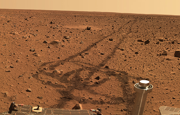

most of the martian little rocks here have sharp edges.. high winds and and high speed dust erosion for millions of years. water should have evaporated into space owing to low G?

There may very well be water on Mars although down in the ground. We don't know the extent yet. Gravity is not the problem on Mars. it is the lack of a strong magnetic field like what Earth has. Mars has a weak magnetic field allowing Solar winds and Galactic Cosmic Rays to directly bombard the Mars atmosphere and surface. A number of scientists now think that over the eons this has eroded the atmosphere away and stopped any formation of life. According to Bob Berman in his book Zoom, if you fear radiation don't even think of going to Mars. Some scientists say just two years on Mars can destroy 13% of your brain cells. Some scientists say 40%!SaiK wrote:one can't argue how the brits did.. no? unless we have the sch-ematics drawn, done a brit sch-ool or a sch-olar in these sch-isms. i think we need to sch-edule our own sch-muck-giris. /ot
