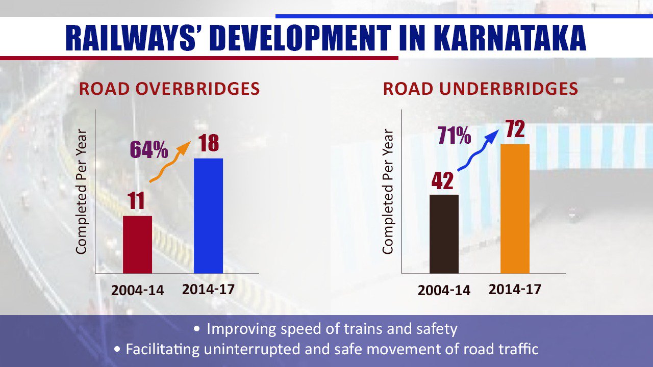

Central Govt, in the last 3 years, has speeded up the development of rail infrastructure in Karnataka, helping improve speed of trains and facilitating uninterrupted & safe movement of road traffic in the state.
