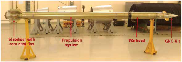

Missile launched PGM and it's 10kg warhead.
