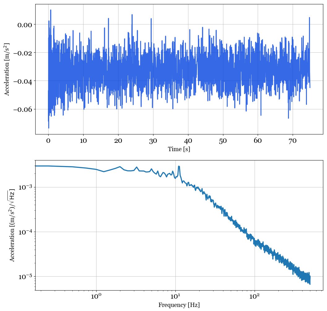

How are they able to isolate the LIGO from earth's vibrations (I know there's a 10 mile buffer zone or something like that) but at that level of precision, vibrations from earthquakes anywhere on earth and minor plate tectonic movements could affect its functioning?

SriKumar - First VERY good question. For serious and worthwhile reply I will suggest do some technical reading - MIT/Caltech's LIGO has some very good article(s).. I have given references before and give some additional reference later.
But basically let me answer without going too-much technical..
First - The isolation techniques are many order of magnitude better than anything previously attempted. This is why LIGO has advanced other engineering processes. These include -
- Best vacuum (In 4Km tubes) possible.
- Best Thermal /vibration/seismic isolation..
ityadi ityadi ..
These truly are mind boggling.. Just for details see, for example:
From Caltech site: Vibration Isolation for LIGO Lab
There are many further advances .. for example Japan's KAGRA (Japan's LIGO lab) has all tubes buried under a mine in a mountain .. thus providing better temperature (super cold - so minimal thermal vibrations) and other controls. Of course eLISA will have everything floating in space - away from atmosphere and other vibrations..
We also know the "local" events effect nearby LIGO more than far away LIGO. Event like black hole merger will effect all the LIGO's.
BUT THIS ALONE IS NOT ENOUGH...
Still a person walking (or car driving far away) will produce much more disturbance than those colliding black-holes.
Lighting miles away -- sea waves on the shore .. (forget about millions of small earthquakes)..
Interesting anecdote - LIGO in Luisiana encountered interesting strange events -- turned out to be hunters using their guns in hunting season, far away, which scientists were not aware of before-hand.
To me what was specially surprising (in the sense that I did not think of it before the LIGO people pointed it out) that even the gravitation field variation due to objects (people, or air mass - cold air is heavier etc) moving caused the effect. (Think about it .. I have never came across any delicate apparatus where one has to take that into account. .
So how do they filter out the noise?
This is another miracle of computer scientists techniques.. (this is where lot of Indian scientists contributed)..
They have taken 'signature noise' of literally 100,000+ such events..(specially how they will effect two geographically separated LIGO's)
(** Yes, I was told that they did add signature for hunters hunting deer in Lousiana among one of those 100,000 library noises :) )
Very sophisticated computer programs filter out those noises.. and can detect black-hole mergers type signature wave pattern among all that noise..
Truly remarkable. ..
Thanks for a good question. Hope this was helpful.

https://www.ligo.caltech.edu/page/vibration-isolation
Vibration Isolation
For an instrument that needs to remain as still as possible, it is ironic that LIGO is so sensitive that it can feel the smallest vibrations from near and far. LIGO is essentially a giant seismometer capable of sensing vibrations from traffic on nearby roads, weather patterns on the other side of the continent, staff biking alongside detector arms, ocean waves crashing on shores hundreds of miles away, and of course nearly every significant earthquake on the planet. Since gravitational waves will make themselves known through vibrations in LIGO's mirrors, the only way to make gravitational wave detection possible is to isolate LIGO's components from environmental vibrations to unprecedented levels. The change in distance between LIGO's mirrors (test masses) when a gravitational wave passes will be on the order of 10-19 m. To achieve this level of sensitivity, LIGO was constructed with multiple levels of active and passive vibration isolation systems. Many of LIGO's larger infrastructure systems that provide some additional levels of isolation are discussed in previous sections.
But LIGO's most sensitive components (its optics) required even more complex and highly specialized mechanisms for isolating them from even the smallest imaginable vibrations.

Very interesting presentation. Wish I had known more physics (topics) to understand some of the slides. I see they used active seismic isolation.
What was used as an (absolute) frame of reference in this case for the vibration detectors- would the mirror ('test mass') itself be used as one? And it seems like they worked out the signals (waveforms) of gravitational waves from various sources ahead of time and searched for that signal.
What is the nature of the signal output from the LIGO photodetector- would it be the intensity of the light vs. time? I assume this is 'all' it would be since it is an interferometer. And I assume the seismic corrections applied to each LIGO would be different (i.e. the WA unit would have a separate set of corrections vs. the LA unit)?...because a single (Seismic or any other large) event would register differently on each LIGO and hence the (magnitude and frequency of) corrections would be different?
If I am understanding you correctly..(If not I am sure you would have found the answer in the links you posted before)
