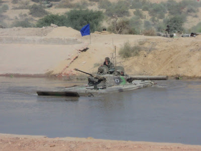

Singha wrote:is the base BMP2 capable of being fitted with flotation collar to cross water bodies? I assume it is not capable of underwater snorkeling, which in any case sounds very risky to me.
It can swim and snorkel at ease
http://cdn.wn.com/pd/42/10/69f9b1c273bc ... grande.jpg
http://www.defencetalk.com/pictures/dat ... _MRB_3.jpg
http://www.armyrecognition.com/images/s ... ws_001.jpg
And that's an IA CIA swimming in Sikkim with a snorkel that gives it much better fording depth than Arjun ;-)
http://img716.imageshack.us/img716/7858/f214.jpg
singha ji it cam swim so i think it dosent need underwater snorkeling
Re: Indian Missiles and Munitions Discussion
how much time , assuming the banks of canal on both ends have been blasted would a tank or IFV regiment of 55 vehicles need to cross over with zero resistance at the other end?
so far the pics I see are of exercises that involve small number of vehicles perhaps to show off to the media, not the real stuff with 100s of vehicles needing to cross within couple hrs with potential of artillery dropping down on the assembly areas.
makes me think for anything major, pontoon or folding bridges would need to be layed instead.

Image posted by Vinay has snorkel at back. If payload is light, it floats. If payload is heavy, it snorkels. Once across and the other side is cleared, then sappers lay bridges.
The BMP series is an amphibian vehicle by design. The Argument of light weight swimming and heavy weight snorkeling defeats the purpose of designing a swimming vehicle for Infantry.
The NAMICA will be similar to the base vehicle when it comes to its motor components.

On the BMP-II floating, the thing floats with full complement of troops. That is how it crosses canals/water bodies and comes on shore. The infantry dismounts after crossing over (if required) and fight along side the armor and BMP-2.

I've always wondered under what conditions do wade, deep ford or swim. I have believed it depends on weight.
Wade http://www.youtube.com/watch?v=fU68_Xba6xI
Deep ford http://www.youtube.com/watch?v=xVdZrzLv ... =endscreen
Wading or swimming or deep fording - not clear. This is an IA CIA at Sikkim http://img716.imageshack.us/img716/7858/f214.jpg
This one is clearly wading but has a snorkel in the back to deep ford http://4.bp.blogspot.com/-r3rzBZCKOfM/T ... 781249.JPG
