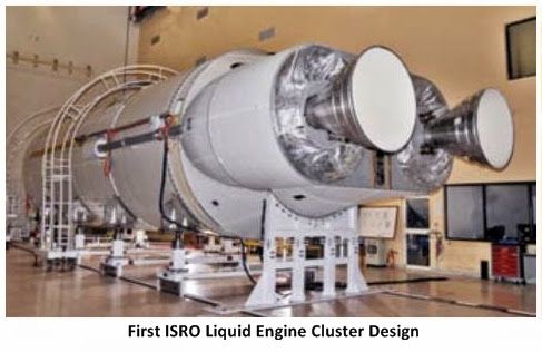

The L110 is a 4 M dia stage and they cluster TWO liquid engines, when there is ample space for 4 . A 4 engine cluster core would have "fixed" the GLSV MK1/2 (like shown for LM3A, and with the same 4 liquid boosters as in present config, would give 5 tons to GTO and removed the immediate need for GSLV MK3) .The Long March's 1st stage is a 3.3 M dia core and the engines are clustered as below. Developing a 4 cluster core engine stage would have been the easiest and shortest path to realizing 5 tons to GTO instead of the costly and long effort to develop and entire new vehicle!

vina wrote:The L110 is a 4 M dia stage and they cluster TWO liquid engines, when there is ample space for 4 .
Are you sure? The engine diameter of each Vikas L110 is 1.7m.

Vikas is 2.9 Meyers and nearly 1 meter wide. L110 is 4 meters wide. To accommodate 4 engines you need more than 4 meters as space for plume divergence is required.Also L110 needs space for nozzle movement for thrust vectoring.

The L110's engines are lit not at lift off, but at high altitude. The nozzle is over expanded if lit on the ground and will be inefficient. The Vikas/Viking engines that are ground lit have nozzles of 1 m diameter.
Check out this link of Vikas and Viking Engines. The Vikas -X , Vikas 2B are analogous to Viking 4B with nozzle dia of 1.7m. Check out Ariane 4. The Viking 4B is used in the 2nd stage. The first stage L220 cluster uses Viking 5C engines which has a nozzle of 1m diameter. The equivalent Vikas 1/ 1+ (from the table in the link I posted) similarly has a dia of 1m. Vikas 1/1+ are the engines used in the GSLV MK1/2 booster stages.
Now the Ariane 4 L220 is a 3.8m diameter stage. It packs 4 Viking 5B engines, with sufficient margins for engine deflection in the x and y planes for pitch, yaw, roll etc. Mounting 4 Vikas 1+ on a 4m dia stage wont be a problem at all.
What ISRO really should have done when they developed the clustered stage for MKIII, they should have done an equivalent of the Ariane-4's L220 stage / Long March 3 first stage,hat would be ground lit and that could have been used first in MK1/2, and then replaced that with a Lox /Kerosene stage for a higher payload to orbit in later versions , and probably clustered the 75KN cryogenic engine into 2*75 KN (like the Centaur upper stage, with comes in 1 engine or two engine versions) and got a full range of payloads from 2.5 T to 10 Ton GTO in a very efficient 2 stage config (when they got the Kerosene/LOX in, but even otherwise, they would have got a good 5 ton GTO capability in quick time with hypergolic lower stages and cryogenic upper stages, CE 7.5).
Instead, for some inexplicable reason, they created an L110 with 2 Viking engine stage that is air lit , an S200 stage ,a brand new cryogenic engine CE-20--infact an entire new launcher family , whose core L110 needs to be replaced ASAP! Sorry, Can't figure out why.

This sounds more like an upgrade path. An ISRO version of L220 with 4-clustered engines can be put in place as the clustered engine reliability increases. This will be more like a natural progression for GSLV-MK III.
