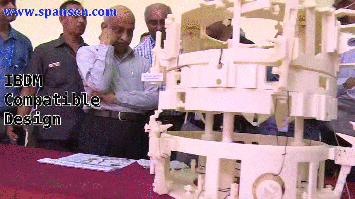

Docking experiment underway at ISAC
via https://www.spansen.com/2018/04/indian- ... iment.html
