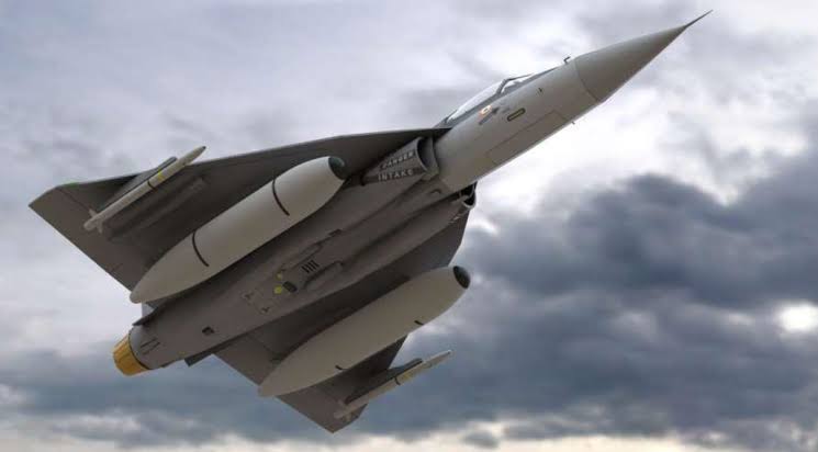

Dancing like an Apsara!! What a beauty!
What would be the take off weight of that weapons load? And as % of max takeoff please.Indranil wrote:Karan,
Anyways, I went back to have some more chai. For Mk1 and Mk1A they are seriously considering 4 BVRAAMs + 2CCMs + centerline tank. But that is nothing new. That config has been on static display. No talks of dual racks. At least that flavor of chai was unavailable to me.
Clean take off weight of Tejas mk1 with 2 CCM is 9800 kg and Tejas mk1a is 9900kg.
4 Derby ER with 40 Kg Nato standard launcher will be 4*(118kg+40kg)=632kg
4 Astra mk1 with R 77 launcher weighing 60 kg will be 4*(154kg+60kg)=856kg
725 litre centre EFT will weigh 725*0.8/0.9~ 640kg.
Tejas mk1a with derby=11170kg(81% of MTOW)
Tejas mk1a with Astra=11400kg(83% of MTOW)
Whether Optronic pod will be carried for passive air to air targeting add 200kg.
MTOW @13800kg.
