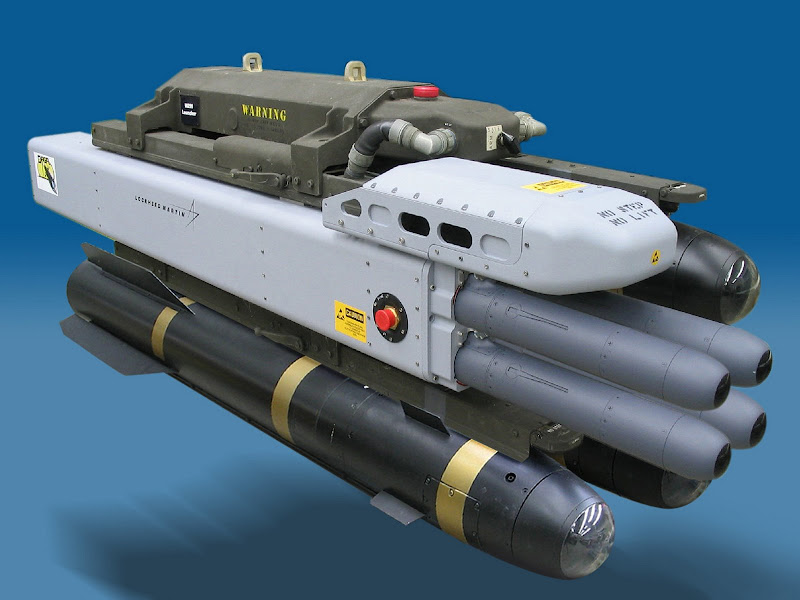

Re: LCH and other Helicopters Discussion Thread
what on earth is that thing in the pic? some kind of octal launcher ?
indranilroy wrote:The most TFTA launcher that I have seen till now is
http://1.bp.blogspot.com/_C-jRcFb4occ/S ... oto2_h.jpg
I think that is a photoshopped image. I cannot believe that the sensitive transparent nose cones of those missiles can be left exposed in close proximity to the hot exhaust of the rockets in the pod.
it real it seems. LM builds this M229 launcher which can take 4 weapons - a mix of hellfires or DAGR (guided rockets) or some JCM (joint common missile). in the pic, one pylon has the DAGR, rest 3 have hellfire IIR version.
http://www.lockheedmartin.com/us/produc ... ncher.html
http://defenceforumindia.com/jh4cz/asse ... rocket.png
http://defenceforumindia.com/hydra-70-rocket-1573
as usual khan does some amazing things in compact pkging, precision guidance etc. btw we have ordered the basic Hydra rockets with the Apache deal.
Could be real. Because that is just a quad-pack Hydra launcher being added to the generic Hellfire quad-missile launcher system(M299) carried by their helicopters and nothing special. As for the exposure issues due to exhaust, if the normal Hellfire launch plume doesnt hurt the other three currently, so would the less sizable plumes of these hydras.

indranilroy wrote: But I have never seen more than 4-CLGM-launcher.
That are normal rockets in a mixed config with ATGMs, but LAHAT and CLGMs are bigger and more powerful than normal laser guided rockets. That's why I said, capabilitywhise they fall between rockets and Helina.
rohitvats wrote:The CLGM type of missile is a non-starter for LCH or any combat helicopter for today's battlefield. For a simple reason that you want your chopper to fire and get the hell out of there. With the proliferation of MANPADS like bird-seeds, a helicopter required to maintain lock on his target till the point of impact is a non-starter. Nor can you rely on ground based lasing of the target. Further, one would ideally want a helicopter to pick couple of targets during each engagement period, fire missiles and get away.
You are missing some points here, my point was mainly to use LAHAT/CLGM with Rudra, since it will be used more in the fire support roles jointly with our ground forces, or strike corps. In a netcentric enviroment, even with UAVs, so carrying up to 16 x LAHAT would be defenitely the better choice, be it self guided, or with assistance from different sources.
Secondly, for LCH it would be an addition at the outer hardpoints, where LCH might only carry twin combos of Helina or normal rocket pods, while you can at least carry 4 LAHAT (with dedicated rocket pod even way more). That multiplies the attack capability of LCH by far, not to mention that LAHAT offers even longer ranges than Helina (8 to 13Km vs 5 to 7Km), so even if Helina will be used, you might have to get closer to the target to use it.
Thirdly, my general point about this kind of missile is, to have a type of missile for combat helicopters as well as fighters in CAS. A rocket pod with LAHAT on LCA + Litening pod would offer credible CAS capabilities, in many situations where LGBs are simply too heavy and can be carried only in limited numbers. So this would not only increase the attack capabilities of our combat helicopters, but also of our fighters.
