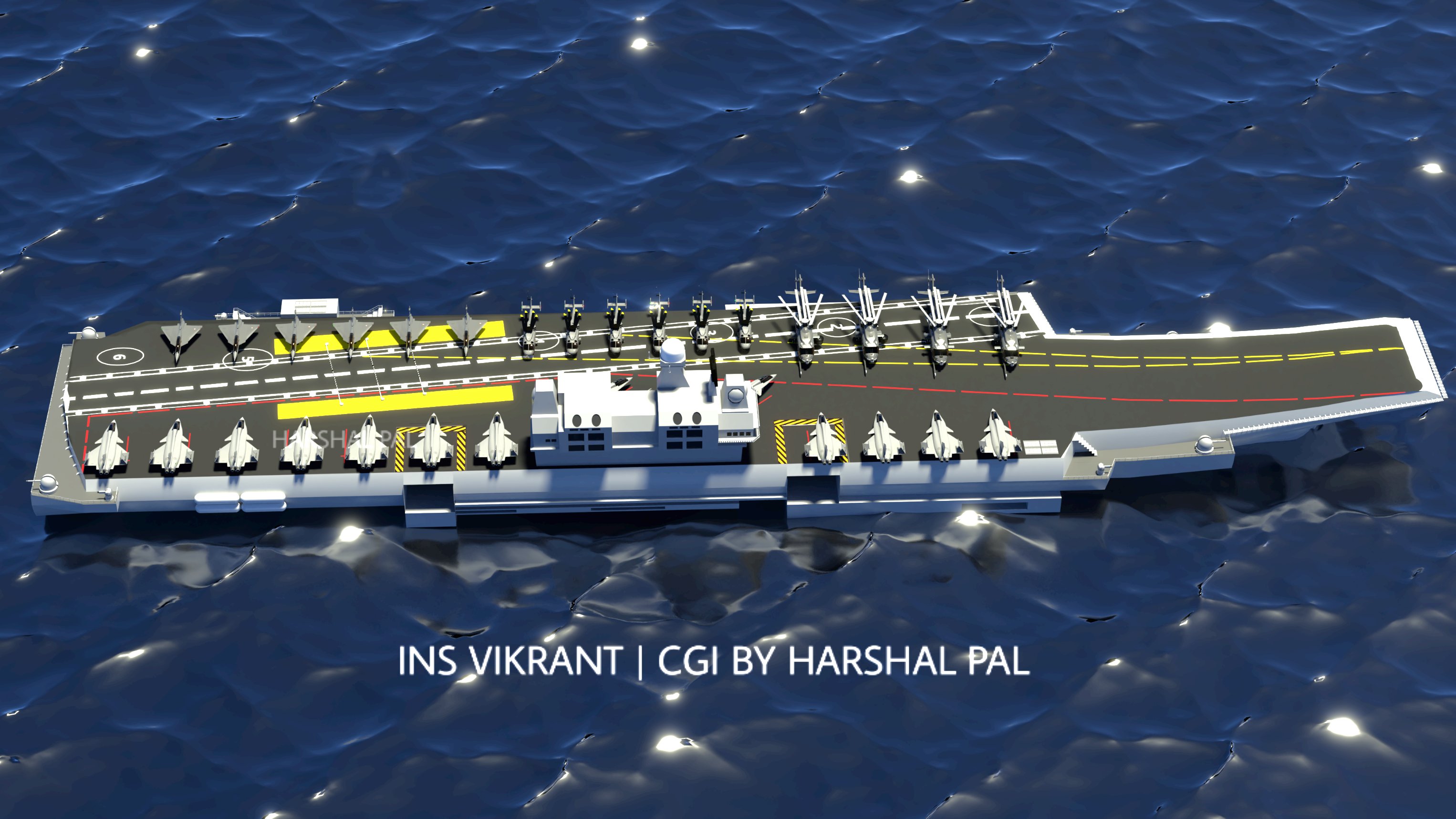

https://twitter.com/HarshalPal5/status/ ... 61836?s=20 ---> IAC-1 with fixed wings.
Further plans:
3x IMRH (AEW)
3x IMRH (ASW/AShW)
4x ALH (utility)
Estimate : 20 fixed + 10 rotary
Suggestions are welcome

https://twitter.com/HarshalPal5/status/ ... 88037?s=20 --->
'All onboard'
IAC-1 / INS Vikrant with 30 aircrafts comprising of
* 12x TEDBF
* 8x NLCA
* 6x ALH (utility)
* 2x IMRH (ASW)
* 2x IMRH (AEW)
https://twitter.com/HarshalPal5/status/ ... 91136?s=20 --->
Correction: 14x Teddys and 6x NLCAs

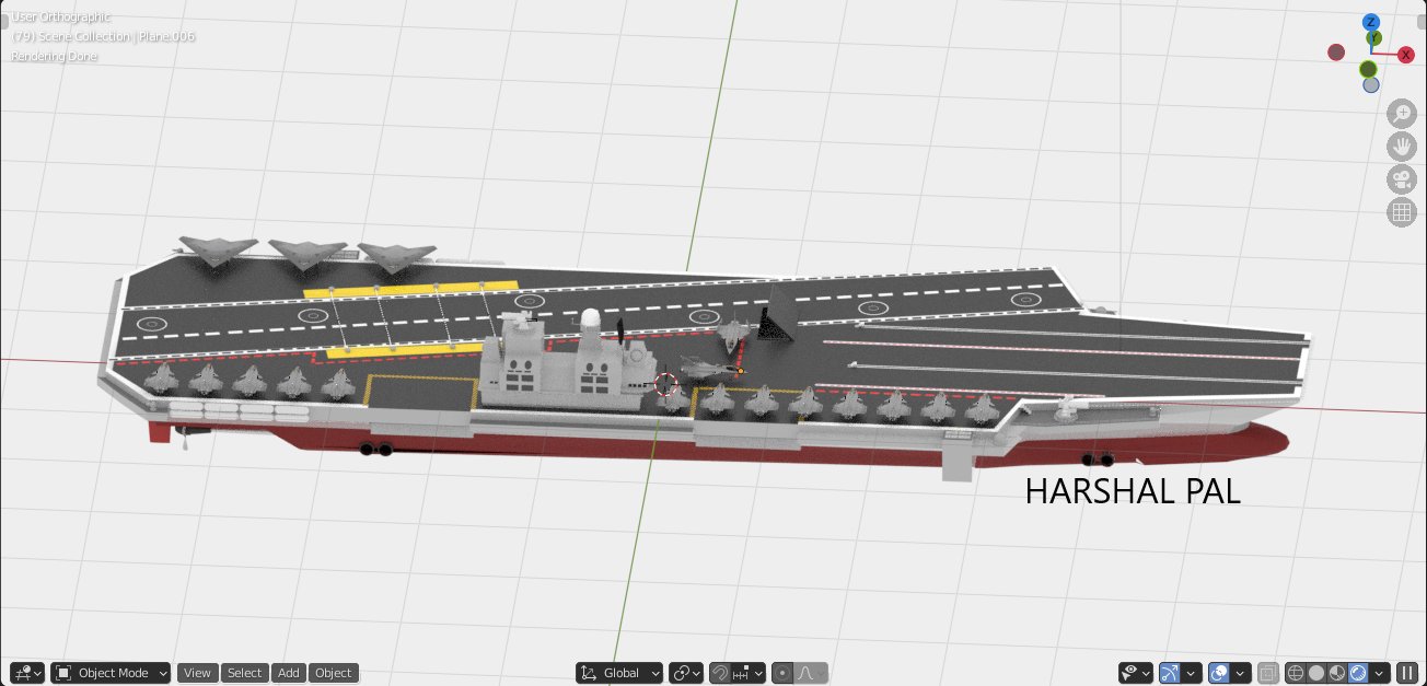

I am seeing UCAVs and TEDBF.
https://twitter.com/HarshalPal5/status/ ... 38983?s=20 ---> My 65K ton IAC-2 (70% complete).
