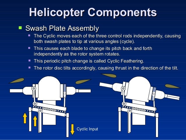

I found a few images on the net on how individual rotor blades tilt can be achieved.
Sorry for the multiple images...

You can see the rotors tilt in this clip.
deejay wrote: Shivji, individual blades can be tilted and taken together all the blades act together to tilt cyclically hence tilting the rotor disc.
A little semantic miscommunication here. Yes the rotor tilts but the helicopter tilts with the rotor.
Does the rotor tilt separately from the body of the helo - that is can the rotor disc tilt 1-2 degrees forward/back or sideways without the helicopter also tilting with it?

I have a problem with Encyclopedia Britannica's explanation. Tilting left and right (banking) are done by changing the cyclic (angle of attack of rotor blades on left and right). The same can be achieved for forward flight using cyclic front and back. AFAIK no tilting of rotors needed.
I have never heard of the extra (fiddly, more moving parts)) mechanism to tilt rotors - which would mean tilting the rotor hub - but I think I can be re-educated if that is true
Changing only AoA will not tilt lift vector in required direction. You could roll or pitch using differential lift but moving sideways or back and forth is not possible that way. Think of it using Newton's third law.
Zynda wrote:I found a few images on the net on how individual rotor blades tilt can be achieved.
To me these two images seem to be showing two different things
The upper image shows the rotor hub tilting separately from the drive shaft/main rotor mast
The lower image seems to show a rigid rotor mast with the swash plate merely controlling rotor blade pitch/angle of attack
Which is correct? I didn't think the rotor disc has a degree of "play/movement" separate from the rotor drive shaft allowing the rotor disc to tilt without also taking the rotor shaft (and rest of helicopter) with it.
The video (to my eyes) just shows rotor blade flexing.
JayS wrote: Changing only AoA will not tilt lift vector in required direction. You could roll or pitch using differential lift but moving sideways or back and forth is not possible that way. Think of it using Newton's third law. Anyway 5 min youtube would get you all the basic info on what are the controls and how exactly they move rotors.
Why would forward and back movement not be possible by changing differential lift? If sideways movement/rolling is possible the same thing could tilt the rotor disc forward and take the helo forward (or back). It there any technical problem in doing that which calls for the added complexity of a rotor disk that tilts separately on the drive shaft?
YouTube and other sources all speak of cyclic but tilting of rotor disc separate from rotor drive shaft is not something that I have read about or seen on YouTube. If you can point me to one such video perhaps I can learn.
