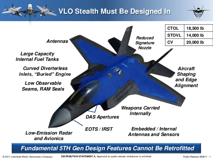

The Rafale will carry EFT's on most strike and even CAP, OCA or DCA missions unless it is used for point defenses. That is how it is meant to perform as it does not carry huge volume of internal fuel unlike 5th gen. aircraft or the Flanker etc, nor does it have optimized CFT's that are a better compromise as far as RCS and drag is concerned. While you may have a choice to ditch the EFT's when entering a defended air-space, you do loose out on the flexibility and expose yourself to potentially longer ranged EW sensors. I don't think the claim that the Rafale is any way a semi-LO platform holds any water. Yes they've looked at RCS reduction where possible but most of it erodes the moment you put any mission constraints on it (i.e. real world usage). That doesn't make it a bad aircraft, in fact it s one of the best in class in its peer group. This is the same problem (mission constraints unable to sustain what designers are trying to sell) that plagued aircraft like the Silent Eagle, or Advanced (stealthy) Super Hornet but at least there at least rudimentary consideration was given to some sort of optimized weapons carriage even though it was inadequate for most missions.Aditya_V wrote:Rafale / LCA etc. will have significantly shorter ranges of detection by radars in clean or even A2A config due to hiding engine blades, use of composites etc. ?
As the current LO fighters have demonstrated, and as the future crop of LO fighters in development will illustrate, LO really needs to be built into the design from the start and this is not just shaping or RAM/RAS but across mission systems, interoperability, training, doctrine, organizational construct and sustainment. Things like doctrine and org. construct are important elements here as LO aircraft need to operate within certain parameters and their mission systems need to enable this. No point in being sig-optimized but having data-links that can be detected by a capable EW system. Hence most 5th gen. platforms come with their own dedicated high frequency directional LPI data-links and a training and interoperability element that trains for EMCON and dicipline via training so as to not give away your tactical advantage via emissions. These aircraft make a best attempt to address all the various ways they can be detected, tracked or targeted and that is the essence of a balanced and optimized VLO aircraft.
There is a very good reason that Dassault, Boeing or others have had pretty much ZERO success trying to push their aircraft as semi-LO platforms when competing against LO fighters and have quickly realized that their best bet is to push them as tactical bomb trucks with larger magazines..No operator objectively looking to field LO platforms has taken their PR seriously..
Saar, 19% additional range is pretty significant in itself but in my limited understanding, what matters is the trio of stealth of aircraft, range of radar/sensors and range of missile. With substantial superiority in all 3 aspects, Rafale becomes a game changer in our theatre.Indranil wrote:Exposed compressor face contributes to frontal RCS. Is an Su30s compressor exposed to ground based radar?
From the bottom if you carry external ordinances you create many corner reflectors whose RCS is significantly high, often much higher than the aircraft itself. If you have to carry multiple ordinances, you can multiply this effect. SU-30 won't be carrying external fuel tanks, while Rafale/LCA will.
Also the distance at which objects can be detected varies as the fourth root of RCS. So, even if I take that Su-30 has 2 times the RCS of Rafale, it will only be detected at 19% higher range.
Rafale is a great aircraft, but let's not add mythical capabilities to it.

But then the French claim that Spectra will give rafale capabilities of a stealth aircraft. Wonder if it is truly that effective or just another french marketing gimmick.Indranil wrote:Exposed compressor face contributes to frontal RCS. Is an Su30s compressor exposed to ground based radar?
On the other hand is Spectra is really as good as the claims wrt active radar cancellation, then what is the need for an extremely long range air to air missile like meteor. A standard mica missile(range>=80 Kms) should be more than good enough
If so, why are they bothering with the nEUron? Why not just stick Spectra on a MALE UAV they are developing? Same with FCAS where they are taking more than 2 decades to field a stealthy next generation replacement to the Rafale. Spectra is a self-protection EW/EA suite and a survivablity enhancer. It isn't a mythical stealth cloak capable of hiding a bomb, and fuel tank laden fighter from enemy radars.darshhan wrote:
Agree with you completely. I mean are Americans, Chinese and Russians fools to develop and induct dedicated stealth aircraft in their fleets. They could also have taken the shortcut like french.brar_w wrote:If so, why are they bothering with the nEUron? Why not just stick Spectra on a MALE UAV they are developing? Same with FCAS where they are taking more than 2 decades to field a stealthy next generation replacement to the Rafale. Spectra is a self-protection EW/EA suite and a survivablity enhancer. It isn't a mythical stealth cloak capable of hiding a bomb, and fuel tank laden fighter from enemy radars.darshhan wrote:
It is logical to invest heavily in a highly capable digital AESA based EW/EA suite for 4th gen aircraft. Rafale has done it, and UAE funded the Falcon Edge for their Block 60 F-16's, and the USAF, the EPAWSS for their F-15E and EX aircraft. All leverage high power, wideband GaAs or GaN devices to support the self-protection needs, leverage digital techniques, DRFM and even have added aids like towed or dispensed decoys etc. etc.. But much like EW systems on board stealth aircraft, their main function is to enhance survivability not transform these aircraft into magical stealthy unicorns..Passive EW via application of VLO materials, shapes and IWB's has no substitute for now. Hence you see the same approach being chosen by everyone that is working on 5th or even 6th generation fighter programs. If there were an easy substitute most would have exercised it and the Rafale would have enjoyed significantly greater success in the export market.
Passive radar evasion is better than active radar cancellation, use that power to use your radar at extreme ranges or ECMs for that matterbrar_w wrote:If so, why are they bothering with the nEUron? Why not just stick Spectra on a MALE UAV they are developing? Same with FCAS where they are taking more than 2 decades to field a stealthy next generation replacement to the Rafale. Spectra is a self-protection EW/EA suite and a survivablity enhancer. It isn't a mythical stealth cloak capable of hiding a bomb, and fuel tank laden fighter from enemy radars.darshhan wrote:

How much will hidden engine faces help though if you have large EFT's and bombs dangling under the wings?Kartik wrote:The bigger problem with the Su-30 is the exposed engine face. No blocker or serpentine intake. It is right in the line of any radar waves coming it’s way. Masking the compressor face with serpentine intakes alone will reduce the RCS a great deal, everything else being the same.Indranil wrote:
Size is only one aspect of stealth. An F22 has a smaller signature than some armaments.
Some profiles will benefit like an A2A configuration with a load-out of few AAMs. Reduced head-on RCS. How much advantage this gives requires a detailed study per airframe type and whether it’s actually worth it for the costs.
Exposed Engines blades are big source of radar images and probably increase the cross section more than Pylons, Drop tanks and ordinance, Also the All Metal Larger body Su-30 will start of with a much bigger radar cross section than smaller Composite built LCA and Rafale, these are not 5th gen stealth birds by any stretch of the imagination but probably have a much lower detection range.
